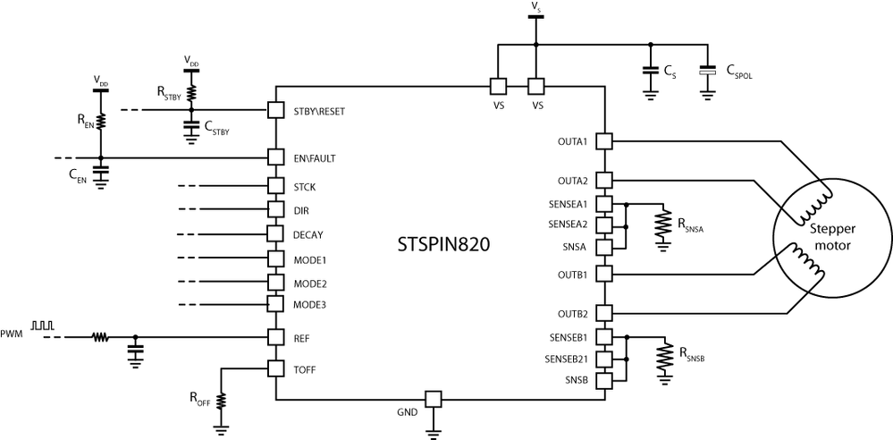

The application is a small linear bipolar stepper motor in a valve with very low power needs. (150-200mA/24V).
It will only be used in full step mode or whatever the smallest divider is.
More important would be a short protection and that it stays cool during normal operation and doesnt exceed 370°C in case of any failures.
Do you have any suggestions on drivers that fulfill these needs?
‎2021-07-12 4:20 AM
Hi @SScho.3​,
for your application I can suggest the STSPIN820 stepper motor driver (small QFN 4 x 4 mm package).
The device offers a complete set of protection features including overcurrent, overtemperature and short-circuit protection.
The device integrates a microstepping sequencer (you can chose the full-step operation setting MODEx = "0").
At each STCK rising edge, the sequencer of the device is increased (DIR input high) or decreased (DIR input low).
The device implements two independent PWM current controllers (with fixed OFF time), one for each full-bridge (the DECAY input determinates the behavior of the PWM current control during the OFF time).
Finally, the device can be forced into a low consumption state.
