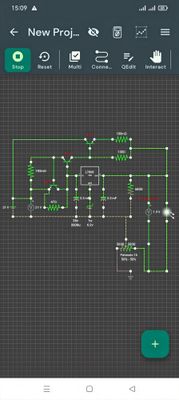

I was design 19 volt regulated power supply, but I don't know the exact value for the transistors, and I noticed at the voltsim output didn't reach the maximum 19 volt output, can anyone help me for the solution for my design, regards.

The schematic shows a current regulator that uses the potentiometer as a shunt. However, if your output parameters are actually 19V, 20A (even though you have drawn 1.9V), there would have to be 20,000V at the 1k potentiometer (20A * 1k = 20kV).
Please explain what your schematic is supposed to do or what you are connecting there, because (at least) something about it is not right.

Why using a fixed 8V reg for a 19V supply ?
You have planned the cooling ? (need a big heatsink, + fan probably )

Actually what you've designed is a big heater with an annoyingly bright lamp.

Okay, done, thanks but...,
What about the T1,T2,T3 transistor type ?and, is my design will run correctly ?
Can you help me to test my design with yours Simulator ? What is the max. voltage output ?

@Peter BENSCH thank you so much for your help, well I see my pot act as a shunt instead as voltage divider. and I guess my 1k pot will give me 13.8 volt at half turn for my Dakai transformer and also can be used to turn my Laptop on at max. turn.
