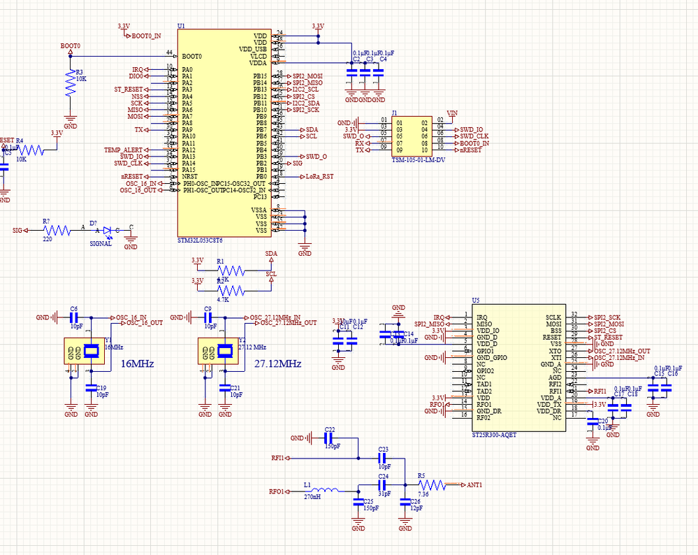

I am entering the world of NFC with a somewhat complex project, but I took the initiative to start it. The goal was to create a sensor that would work only with Energy Harvesting from the reader.
For this, I chose the ST25R300 chip to be the chip for my reader board and sensor power supply, mainly due to its high transmission power.
I am having difficulty getting it to work properly. Basically, I ran several tests with some DEBUG codes on the reader board. In these tests, I found some inconsistencies. The first is the VDD_A voltages, which come from a reading of the chip itself, which is registering almost 6V, and the other inconsistency is the RSSI giving 0.

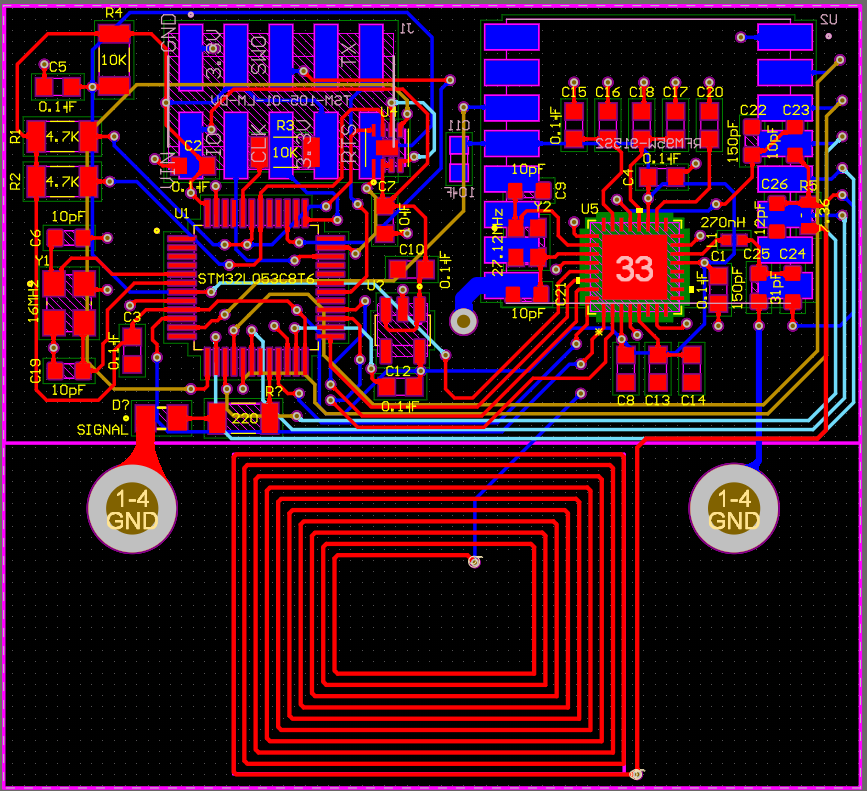

I believe the error is in my antenna and matching circuit. I would like someone to help me improve this system by pointing out where I may have made a mistake in their design.

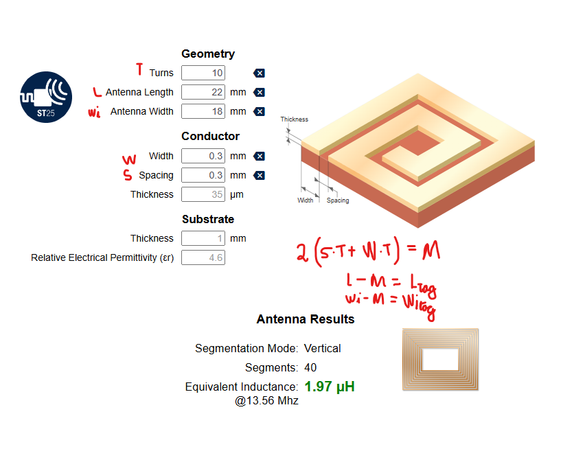

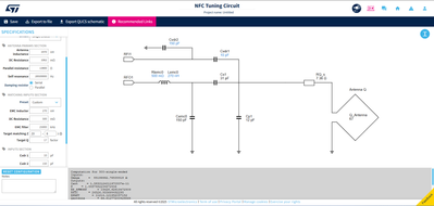

I made the antenna using the ST website (eDesignSuite antenna design tool). I also made the maching circuit using ST's eDesignSuite.

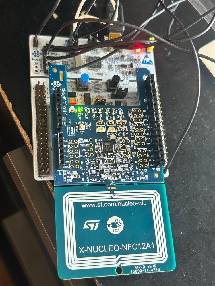

In addition, my circuit was largely based on the core board (X-NUCLEO-NFC12A1).
The main premise was to develop something small that could perform energy harvesting, so I made a 10-turn antenna, which is larger than the TAG antenna. I made a mistake in developing a single-ended antenna instead of a differential one, but I wanted to start with something simpler first before perfecting it.
Could the design of a 10-turn antenna for the ST25R300 prevent the RF driver from oscillating to the point where the RSSI is zero, or does the VDD_A value suggest a hardware failure in the analog stage?

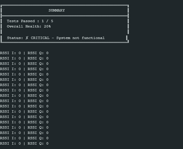

Observations:

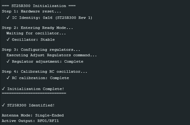

  • The chip responds to SPI and returns the correct ID (0x16).

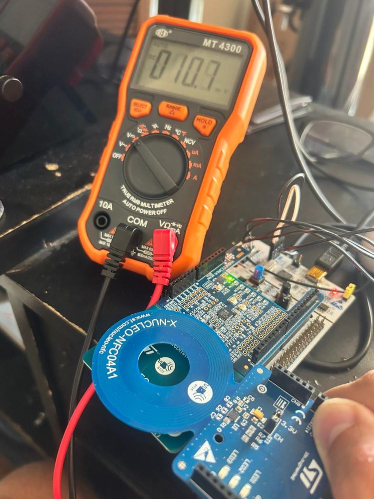

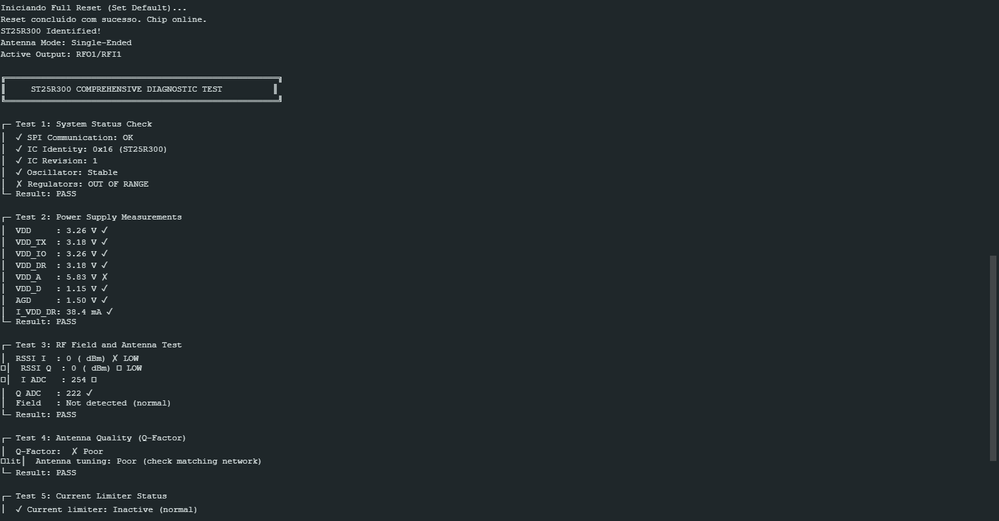

  • When enabling the RF field, RSSI does not fluctuate and remains at 0.
  • The ADJUST_REGULATORS command was executed, but VDD_A remains abnormal.
  • I have already disconnected the antenna to try something more direct by removing resistor R5, but even so, RSSI remains at 0 and the voltage remains the same at VDD_A.
  • On the PCB, I removed the ground plane on the antenna side.
Abnormal VDD_A levels: Is it physically possible for the ST25R300's internal VDD_A regulator to report 5.66V when the main V_DD supply is only 3.25V? Could this be a symptom of RF energy reflecting back into the RFI pins due to antenna mismatch, or does it point to a specific fault in the internal LDO/ADC reference?
ADC RSSI saturation: My diagnostics show that the channel I ADC has reached its maximum of 255, but the RSSI remains at 0. This saturation usually indicates that the receiver stage is being “blinded” by self-interference. Is the high Q factor of my 10-turn antenna Q = 66 the likely culprit for this behavior in a single-ended configuration?
Are all these problems reflected by my antenna being small but with many turns? Even when I test without it in the circuit?

Brian TIDAL
Hi Matheus,
It is recommended to use the RFAL middleware for application development. The RFAL provides support for various NFC protocols and includes the ST25R300 low-level driver for register access.
For information about the RSSI, see section 5.4.7 of the ST25R300 datasheet. In particular "The RSSI information can be read after a tag reply without any timing constraints."
The nominal voltage of VDD_A is 3.0 V. The conversion factor is 5.9. The typo in the Datasheet DS14655 - Rev 2 has been reported internally and will be fixed in the next revision.
Regarding the Design verification of the antenna, make sure to follow section 9 of AN6092 Antenna design for ST25R500 and ST25R300 devices.
Also I suggest to run you code on X-NUCLEO-NFC12A1.

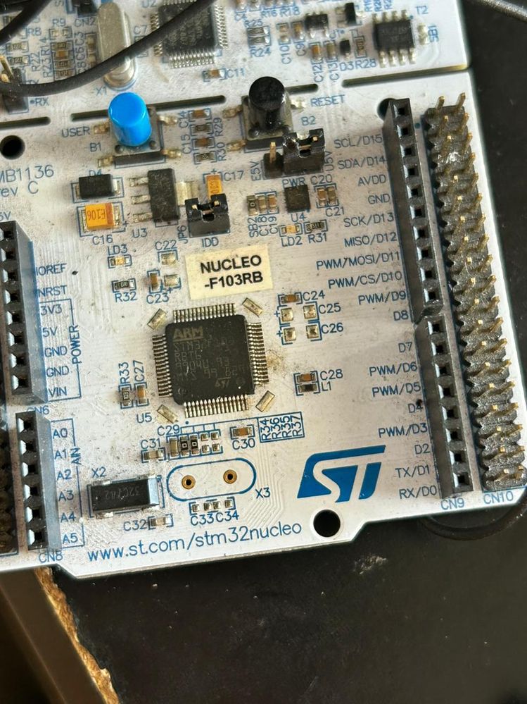

Good morning, Brain! Thank you for your reply.
I think my best option right now is to use X-Nucleo instead of starting with my own design right away. That said, I bought an X-NUCLEO-NFC12A1 board to start testing.
I didn't know about RFAL, I would like to use the polling example to test my board. But I don't know how to adapt it to use the example. In my case, instead of NUCLEO-L476RG, I have a NUCLEO F103RB. I tried to run the example located in "...\STMicroelectronics\ST25NFC_Embedded_Lib_ST25R500_1.8. 0\Projects\STM32L476RG-Nucleo\Applications\X-NUCLEO-NFC12A1\polling\STM32CubeIDE."
However, I did not get the logs in the serial to know if it worked or not, but I think I did it wrong, since, as I mentioned, I tried to load the example made for the L476RG directly into my F103RB.
I would like to know how I can better use this middleware, first to make this polling example work on my Nucleo board. And later, how can I put this middleware on my custom board (I don't know how to create a project with it integrated).

Good morning, Brian! Thank you very much! I finally got it working here.
Now I have another question. Please correct me if I should open a new thread for this instead of posting it here.
My problem is increasing the EH voltage of the ST25. As I said earlier, the goal is to power a set of low-power chips with it. I measured it in an improvised way to get an idea and arrived at 10mV on the EH pin. I don't know if I did this measurement correctly.
What can I do to increase this to perhaps 1V, for example? Would it be possible to reach up to 3V in EH?
