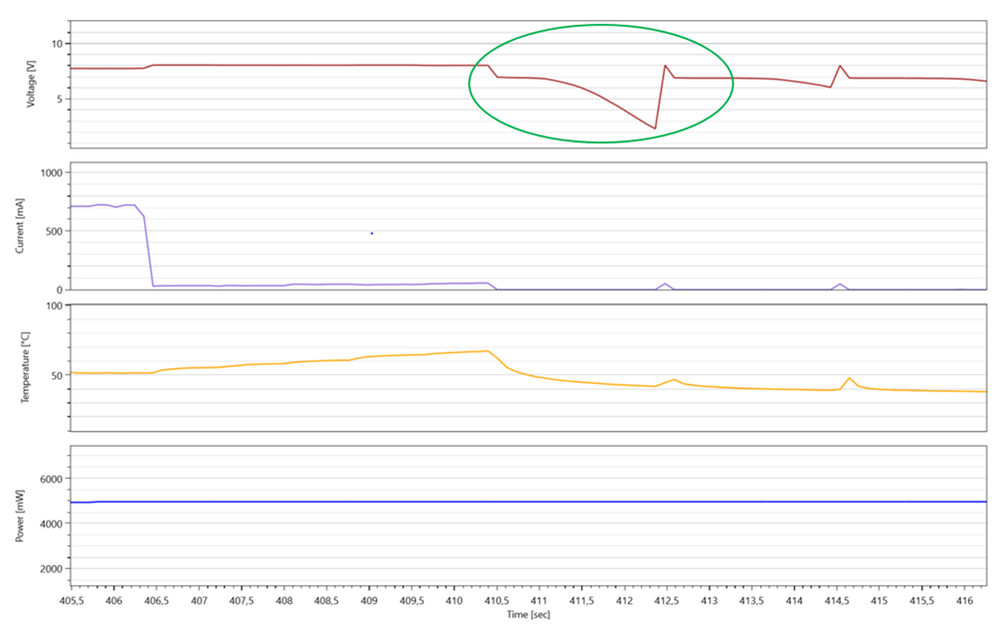

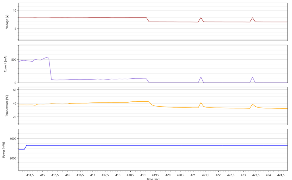

In addition, I have conducted further tests with default parameters on both boards (both the STEVAL Evaluation Board and my WBC86TX PCB), and I have recorded the following charts directly from WPSTUDIO's "Charts" feature, hoping they may be useful to your community in assisting me with resolving the issue:
FIG 1
FIG 1 depicts the operation of the STEVAL-WBC86TX: after a certain runtime (approximately 419 s), as indicated by the "Voltage" graph, the system transitions from 8V to 7V when the receiver is removed and returns to the PING phase.
Now, considering the following graph referring to my PCB (WBC86TX):
FIG 2
FIG 2: Initially, the board was functioning correctly as it transitioned from the transmission phase to the Ping phase. However, after a certain period (approximately 410s), the Voltage dropped significantly before returning to the Ping phase. After bringing the receiver close again, the system became stuck, as described earlier.

2.From you picture 2, TX input voltage drop from 8V to very low, TX chip have reset, also chip temp is higher than STEVAL-WBC86TX.Seems your TX have some damage.

From your picture2, when you remove RX, TX chip temp rise from 50C to 70C. Seem TX chip consume many power inside, It is different with picture1.
How about you increase input limited current, Or set  WBC86TX input voltage lower.
