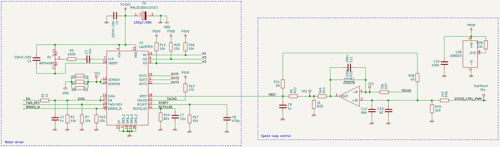

I make a board with a L6235PD driver. On a population of 5 controllers, 3 have a problem.... Means that when the Vref is @0V, the motor still running (at low speed, but still running).
FSamu.2
 I've certainly a problem with the RC OFF and RC Pulse definition....
On RC pulse: 82k / 22nF
On RC OFF: 91k/470pF
Do you have an idea to solve my problem??? Thanks for your help.

For a better support could you share your custom schematic?

FSamu.2
Hi Christiana, Thanks for this answer.
We would like to not use the pin brake so as not to run the motor and have a motor that does not run with Vref at 0. Do you think that if we modify the Toff (big enough compared to the min on time) the motor will not run?
Do you have another idea to compensate for this offset?
Here is my schematic:
Hi @FSamu.2​,
the device is designed to impose a phases current except when it is in brake (BRAKE low) or when disabled (EN low).
Making the current very small by stretching the Off Time would seem to be the best strategy, but on the other hand you would have very large ripple during normal operation.
This important drawback, makes the strategy not applicable.
If you feel a post has answered your question, please click "Accept as Solution"
