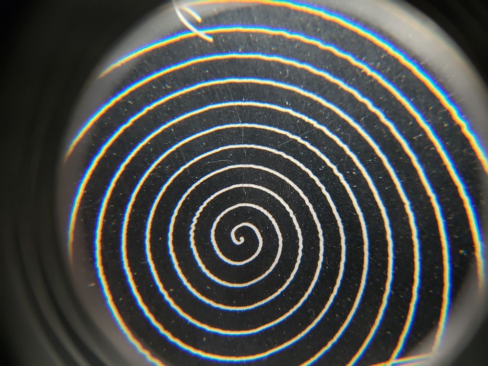

I am trying to do laser engraving with a POWERSTEP01. But I get high frequency oscillations on my motor.
CBeif.1
I am in current control mode, and the stepper motor is using about 3 amps.
Is there anything I can do to reduce these oscillations.
Also note that the white line is about 0.010" thick.
I am using x16 microstepping, and I currently have 1600 microsteps per inch of resolution.

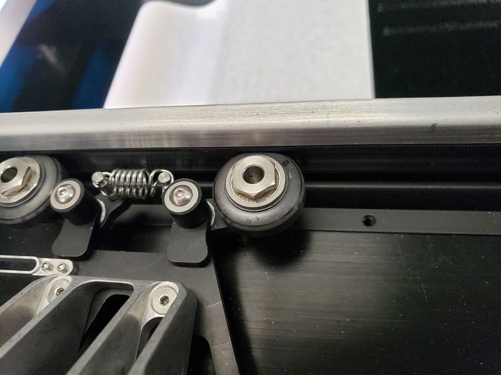

And further the used motor and the parameters, you use for initialization :) A picture of your mechanical setup could be also helpful (ball screws ? belt driven ? linear bearings ? moved masses ? ... and so on ... )
CBeif.1

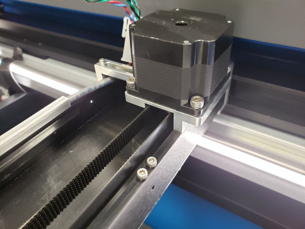

0693W000000Wc9QQAS.jpg0693W000000WcB1QAK.jpgThe application is a laser engraver.
The movements are made with an XY gantry on rolling wheels in a track, using a stepper motor attached directly to a belt drive,
We have other systems that don't have this problem.

​In practice you have two stepper motors each one driven by a powerSTEP01 device, right?

Analysing the picture of the "spiral", i would say, there are two problems coming together:
a) the axles are called alternately, so (for example) x makes a movement, then y, then x again and so on ... Soluition would be (if you use the provided libraries, the according functions are already implemented) to use command queueing or to drive them with external step signals.
b) if the timings aren´t set up correctly, this driver unfortunately tends to "swallow" microsteps and moves in rough full steps, when enough microsteps are "cumulated". In such a case try to play around with minimum on time, off time and so on. always keep an eye of the resulting current, this can be really tricky. You can easily test this behaviour: Try to turn one stepper really slow, maybe 5 MICROsteps / sec. (don´t use the goto command for that... You can´t set the minimum speed low enough. Even with 0 it performs at least 5 full steps / sec.) and watch the movement. If it turns smoothly, your settings shouldn´t be too worse ;) As far, as i remember you should switch off the Low Speed Optimization also (i stopped using these powersteps and his little brothers and sisters a long time ago, because ALL other brands have been FAR better supported and had much less trip hazards...)
Search for the " DS9836 " documentation and read it very carefully. Many trip hazards are well hidden in the description of the single functions...

Also note that the thickness of the engraved line is about 0.01"
the full step distance is also 0.01" so I am worried that I am somewhat depending on the positional accuracy between full steps,
and I am concerned that the motor is vibrating between the 2 full steps.
