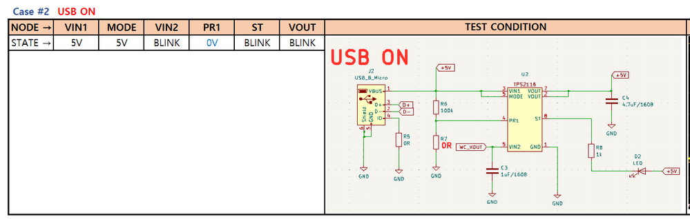

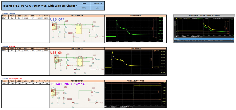

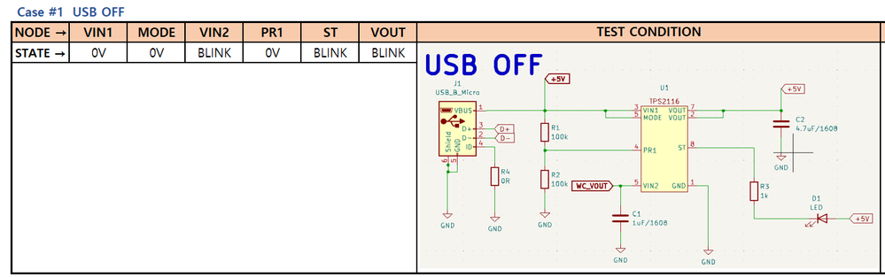

Now I am facing the problem regards to using power Multiplexer, get input two inputs separately( Wireless charging voltage , USB-C Type 5VDC) and outputs the single supply among the two inputs.
The problem is, as far as I understand, the wireless charging's output voltage does fluctuates so hard while Mux's safety input voltage range is narrower than the former, so the Multiplexer seems constantly continues resetting on and on.
I will attatch very simple diagram of the Multiplexer IC ( It's made from another company, but I guess you well aware)
 I've tried connecting directly the wireless charging's output node into the Load, removing the power mux IC, and it worked.
Does anyone developed wireless charging with the option of using USB type wired charging as well?
Or could you recommend the power Mux that can possibly use with wireless charging IC ?
Sincerely Yours, Jake Kang.
JAKE2
I have tested three different case, could anyone recommend a power mux IC instead of TPS2116 ?

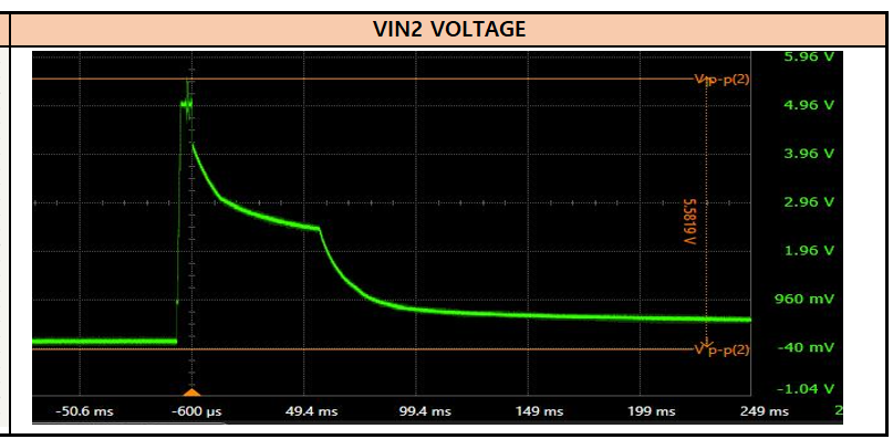

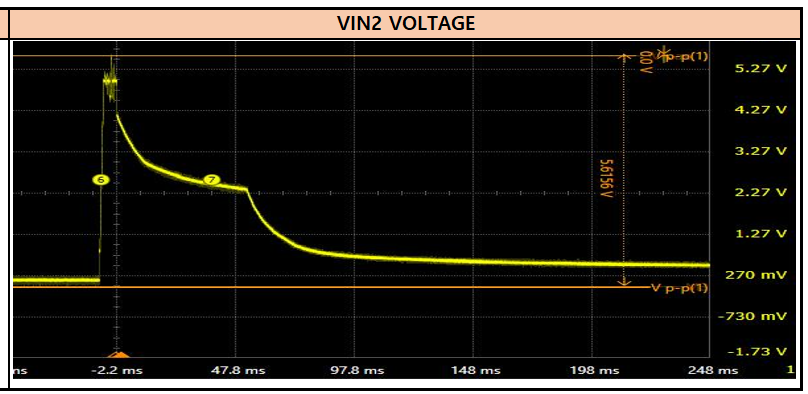

Didier HERROUIN
The output voltage from STWLC38 is not supposed to oscillate, it should be stable as it is a LDO output.
Could you attach a zoom of the period of time where VIN2=5V and then it falls ? It is difficult to see on the plot the behavior of VIN2 and if it exceeds 5.5V.
If you suspect a overvoltage protection by TPS2116, you could try (for testing purpose) to set Vout=4.5V using STWLC38 GUI.
Then, which configuration do you use inside STWLC38 ? I understood that you have modified several parameters, it may be a reason of instability. For instance, if you have increased the minimum operating frequency, you will get less power available at Vout. In your 3rd case, have you tested that Vout is still stable when you draw some current ?

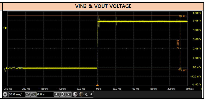

JAKE2
↑ Here's the zoomed Waveform.
RX ARC THRES = 6.0V → 4.0V
RX BPP VOUT SET = 5.0V → 4.5V
when adopted  the voltage that you metioned, the it works well to do so.
→ I haven't tested yet, it just starts working fine from today.
