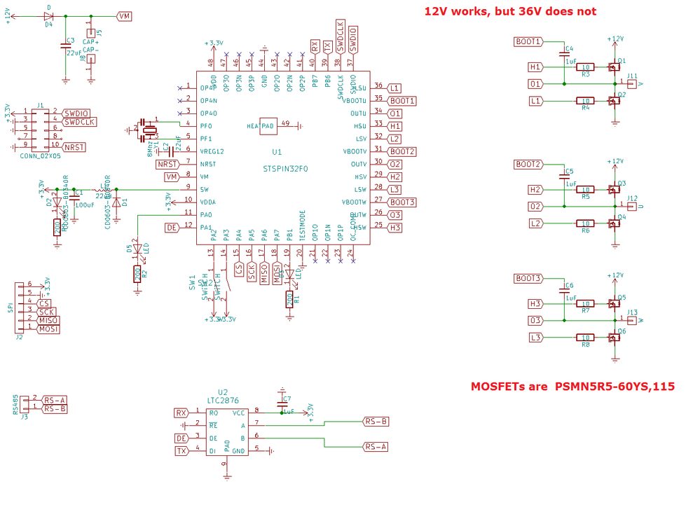

Max, did you by any chance resolve your problem? I'm having similar problem: my custom board works fine with 12V supply, works fine with 36V supply when motor is disconnected, but STSPIN32 chip dies immediately with 36V when motor is connected. Any ideas?

Misha K
March 9, 2018
Posted on March 09, 2018 at 11:19
TJ thank you for your comment, can I please have another one
I do have a scope, however I can capture only one event and then the controller dies. And I'm not even sure which point to probe. I'm trying to collect more clues before I try that
Power cable is 1.5 meters. Driver to motor is 10cm.
Question: OK, I can use overvoltage limiting IC like this one:
https://www.maximintegrated.com/en/products/power/supervisors-voltage-monitors-sequencers/MAX6398.html
this will protect me from overfoltage on the power rail. What if it comes from the motor windings itself? What can I do about that?
Thank you very much, I hope you respond

Misha K
March 10, 2018
Posted on March 10, 2018 at 02:12
TJ your help is highly appreciated, sorry for not being as collaborative as you are
I attached the schematic.
My main confusion is where the overvoltage spikes might occur: on the power rail or on the motor windings. Power supply spikes I can take care of. Motor spikes I have no idea.0690X00000609sbQAA.png

Misha K
March 10, 2018
Posted on March 10, 2018 at 03:15
its all in the motor drive circuits, can you send that ?
STSPIN32F0 has 3-phase driver integrated. This is why it can drive MOSFETS directly. It also has 3.3V buck converter integrated. That is the beauty of it! So I don't have any other schematics to show you except what you see in the picture above. If I did not understand you correctly please explain.
Did you ever make a switch mode power inverter?
No I have not actually
 You are talking to beginner.
these are all the same parts, you are generating huge spikes.
Yes I believe so. My problem is what to do about it...
Which Fets are you using ?
I mentioned them in the screenshot. These ones:
https://assets.nexperia.com/documents/data-sheet/PSMN5R5-60YS.pdf
can you see the G-S breakdown voltage, this is usually where the smoke starts.from.
Vgs MAX = 20V.
HOWEVER! This is
STSPIN32F0 that dies, not mosfets. I can tell because it does not generate 3.3V any more. If I turn the board on without motor I can see the led. If I do it with motors, it dies. Does it light up for a second? - I'm not sure.
are you using a stepper motor ?
No actually, I'm using this gimbal motor:
http://www.iflight-rc.com/ipower-motor-gbm8028-90t-brushless-gimbal-motor.html
if it is wired incorrectly, it is your problem.
I don't think there is a way to wire it incorrectly.
is it a 3pole stepper?
Nope.
to prove the success of your circuit, replace the motor with 3 resistors. say 10x -100x more resistance.
I'm afraid I have no suitable resistors right now. However a) it works at 12V with motor and it works at 36V with no motor. Only 36V with motor kills it.
then with your scope, check that the 'poles' of each resistor are being driven at 180degrees.
Successful operation on 12V proves that.
motor circuits please?
Sorry, as I said before I don't know what else I can give you. Please explain.
Also many thanks for your help. It is greatly appreciated on this end, I promise you

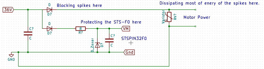

T J
Senior III
March 10, 2018
Posted on March 10, 2018 at 23:50
try to implement the circuit I gave you
