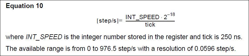

Hi, I am currently implementing software/firmware for the PowerSTEP01 chip and discovered a inconsistency in data sheet https://www.st.com/resource/en/datasheet/powerstep01.pdf. For parameter INT_SPEED (section 11.1.11 in datasheet) the equation does correspond to the stated limits.
It says:
i.e. steps/s = INT_SPEED × (2^−18) ÷ (250×10^−9)
  • For smallest possible INT_SPEED=1 you get the minimum value:
steps/s = 1 × (2^−18) ÷ (250×10^−9) = 15.25
  • For largest possible 14 bit value you get the maximum value:
step/s = (2^(14+1)−1) × (2^−18) ÷ (250×10^−9) = 499984.74
But according to datasheet equation results should be in range 0 < steps/s < 976.5.
So what is correct?
NOTE: This question and answer originated from a customer support case which was handled by us. We regularly review support cases and add any helpful ones here for all to benefit from.
Central SUPPORT
Senior II
You are right, thank you for raising this issue. In fact, there is a typo in datasheet. The correct formula is:
i.e. steps/s = INT_SPEED × (2^−26) ÷ (250×10^−9)
Same mistake applies also to L6480 datasheet :persevering_face: , but at least L6470 datasheet is correct :) . Control logic is the same for all 3 devices.
Mistake in datasheet will be corrected asap. Sorry for the inconvenience.

MHall.4
I have just downloaded the 'latest' datasheet and this change has not been implemented
jagor34
I second MHall.4,
ST, we'd like more clarity on this. A datasheet revision would be very nice.
Hello @MHall.4 & @jagor34
finally you can download the last datasheet revision of powerSTEP01;)
