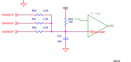

STSPIN32F0 Overcurrent detection R43 value
TYama.17
According to the reference circuit, R43 is 75kohm.
Also UM2154 User manual said that R43 should be higher than 30kohm.
What happens if R43 is 22kohm. Is overcurrent detected by STSPIN32F0?
Cristiana SCARAMEL
Hello @TYama.17​ and welcome to the ST Community.
The first effect of lower R43 is an higher current consumption from VDD.
Moreover, it is recommended to use a bias resistor (R43) more than 10 times greater of the resistors on the sensing lines (R50, R51, R52).
You can find more details on the proper sizing of overcurrent protection in the application note AN4999
Let me know if these info are useful to you, if yes please "Select as Best" label to close the topic.

TYama.17
Cristiana san
Thank you for you comments,
By the way, what is STSPINF0 behaiver when overcurrent occurs?
TYama.17
In addition, I tried to measure the voltage of C21 (GND-OC Comp) by osiloscope, but I could not because STSPINF0 seemed not to work.
Could you teach me how to measure this voltage?
Also could you give me suitable capacitor value for C21. (is 2.2uF suitable?)

Hi @TYama.17​,
the value of C21 capacitor in the STEVAL-SPIN3201 evaluation board is 1 nF as shown in the schematic of your first post.
If you want to change its value the details on the proper sizing are always on the above mentioned application note AN4999

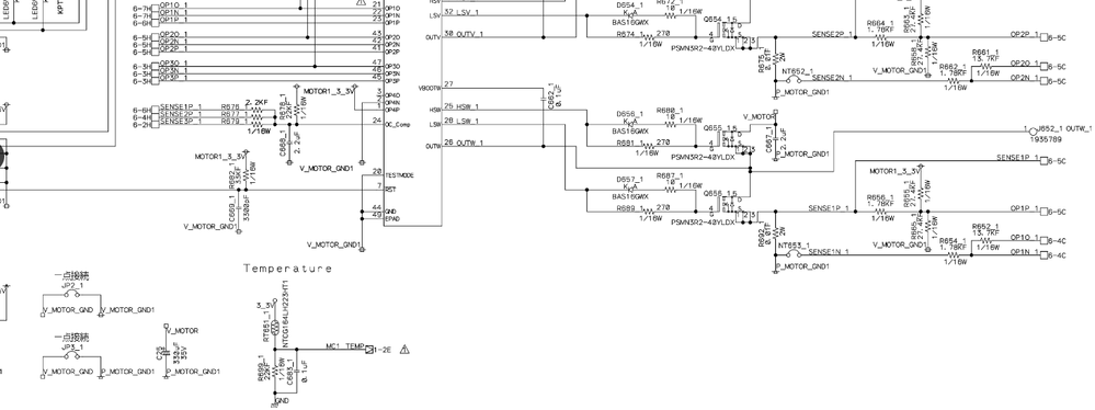

TYama.17
Hi Cristiana san
My schematics is as follow. Unfortunataly I am not familiered with algorithms.
I tried to measure the voltage of OC_Comp on C668_1(2.2uF) capacitor by osilloscope, but I could not see 3.3V from STSPIN32F0. (I did not measure the 9-pin signal).
Is this information specific for you?
Hello @TYama.17​,
a portion of schematic is not enough for a better support.
I suggest you to check if all the supply voltages are present and if the devices is properly programmed (the  STSPIN32F0 must be programmed to work).
If you feel a post has answered your question, please click "Accept as Solution"
Hi Cristiana
I finally measured the voltage of OC_COMP pin between V_MOTOR_GND1 and OC_Comp pin. I was very noisy, I guess GNDing is not suitable on my board...
