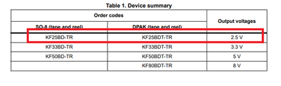

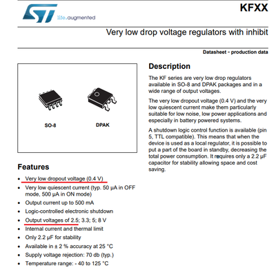

mƎALLEm
https://www.st.com/resource/en/datasheet/kfxx.pdf
With a dropout voltage of 0.4V.
3.3V - 0.4V = 2.9V > 2.5V -> OK
