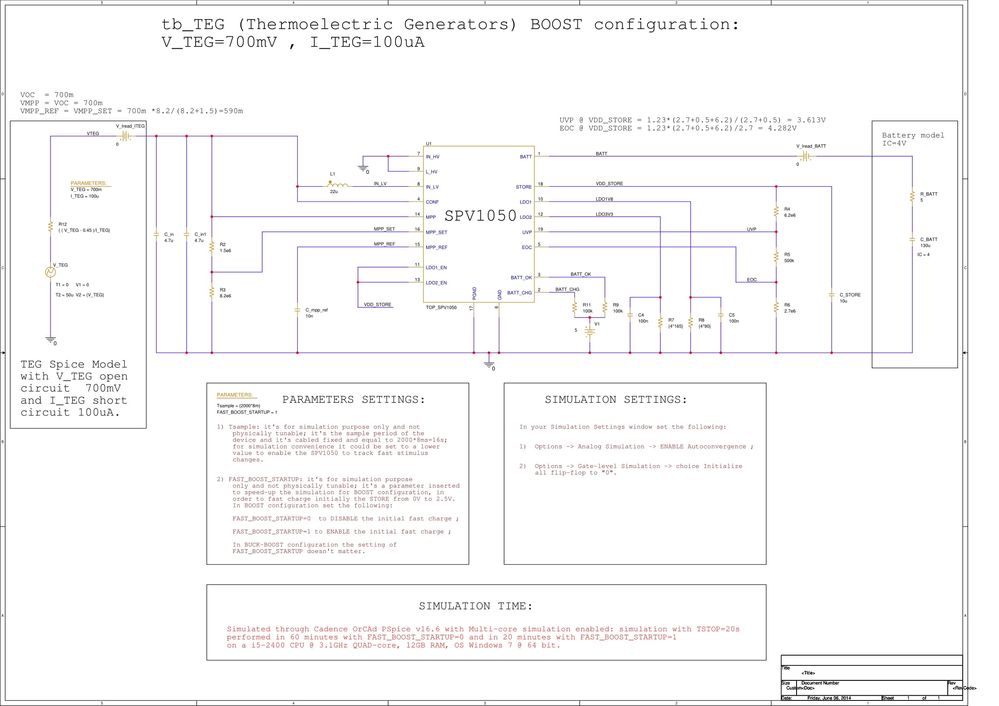

asking question about ic spv1050
Moonji
I am currently doing a project regarding thermal energy harvesting using TEC Peltier modules and an spv1050 IC chip. I constructed the circuit according to the website-sourced datasheet of the spv1050 and the picture below. However, I didn't get the desired output voltage. The input voltage from the TEC is approximately 500mV and should boost more than 3.3V. But the Output voltage from the V store that I manage to catch is about 2V only. the ldo1 and ldo2 pins from spv1050 also the simulation I get 1.8V but when using a 0693W00000Uo8XwQAJ.jpg component to do a process fabrication I cannot get the result. Is anyone have experience using this kind of configuration and can tell me what is wrong? Thanks in advance!
