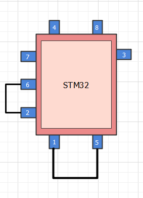

When we generate the PWM pulse in all GPIOP's, if any of the 2 ports or more having interconnection, how to identify or recognize by using the PWM pulse?

Generally something like this is known from the schematic. It shouldn't be a mystery.
To see if pins are connected, set one of them to input mode with pulldown, set the other to output high, and see if the other one gets set high. This is not a perfect test but it will work if those pins are otherwise floating in the system. There's no need to use a pulse to do this.
May 7, 2025
What I want is, from the master without sending the specific request of rotating the direction of ports, we should read the status of which are ports having the interconnections.

Pin tester or board identifier would be my guess.
I'd want to avoid driving two pins connected together at different levels.
Would perhaps use OPEN DRAIN, PULLED HIGH identify all inputs that are HIGH, and then cycle thru setting one LOW and decimating the list, floating the original pin, and back-testing the others to affirm continuity.
Yeah, could probably do a one-to-many with inter-modulating PWM, but seems over kill, and depends on TIMx CHx connectivity to the pin(s)
May 7, 2025
Yes, we are trying to do as continuity tester, where I can do the broadcast message sending to slaves to collect the status of short circuits...

So forget about microcontrollers to start with.
Just think about how you'd do this as just a basic electrical test - with a battery and a bulb or voltmeter.
Are you restricting yourself to just simple galvanic connections? ie, no semiconductors?
Are you restricting yourself to each pin only ever being connected to one other pin?
etc, etc, ...
There must be plenty of info out there on the interwebs - people have been making automated cable testers and continuity testers for decades ...
PS:
"Detecting when pins are connected together" is essentially what a keyboard scanner does to detect when keys are pressed ...
