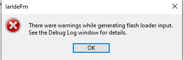

Hi, I would like to know the procedure to execute specific functions from RAM.
I have tried __ramfunc at beginning of the function but it requires all the subsequent functions also to be run from RAM. This would require lot of manual code updates. Is there a way to do it from linker script? I tried placing the functions like below but it would not move the function from ROM to RAM.
place in RAM_region { readwrite,
                                    block CSTACK,
                                    block HEAP,
                                    readonly object function1 // this is my expected function to run from RAM
Did you test the project I shared as it is and checked how it works?
Are you using an RTOS? if yes start with a simple code (without RTOS), then move on to a complex code.
For the interrupt, I suggested to follow the application note section: 2.2 Execute an interrupt handler from CCM SRAM.

I am using STM32H573VI MCU and IAR 9.30.1 IDE. I went through the article but it did not contain the required information. There exists lot of code currently written by other over so many years and now we are facing timing issues. To increase the execution speed, we are tying to run specific functions only from RAM. How do I select those specific functions via Linker script and do not disturb the code base?
Hello @nagarasr ,
Please refer to this application note section 2: https://www.st.com/resource/en/application_note/an4296-use-stm32f3stm32g4-ccm-sram-with-iar-embedded-workbench-keil-mdkarm-stmicroelectronics-stm32cubeide-and-other-gnubased-toolchains-stmicroelectronics.pdf
Thank you for directing me to the section. I tried but now the code does not run properly with these settings. I get a pop up indicating there is a warning in flash loader and map file generates so many veneer sections (I have no clue about these). Below is the debug log for the same.

Wed Oct 16, 2024 13:05:28: Flash download warning: 18676 out of 18676 bytes from data
record CODE:[0x2009'0000,0x2009'48f3] will not be flashed
Wed Oct 16, 2024 13:05:28: There were warnings while generating flash loader input.
Wed Oct 16, 2024 13:05:28: See the Debug Log window for details.

Hello @nagarasr
As the designer of this article, the instructions (Case 1) given to place one or more functions in a SRAM region use the same method regardless of the development tools.
In your code, you will not be able to do otherwise than to rewrite the functions to be placed and executed in SRAM as I explain in the article. Just like GCC, any other IDE with its compiler and linker will always use specific directives to be integrated into the declarations of the functions concerned. This works in combination with the linker configuration.
Have you consulted the IAR EWARM help on the directives and how to create regions in the IAR linker .icf file?
IAR EWARM uses the #pragma location directive that can be applied to variables and functions.
I can suggest the following IAR help chapter:
Compiler reference > Efficient coding for embedded applications
In Controlling data and function placement in memory, there is the following chapter: Examples of placing functions in named sections

Sorry I cannot help you about the log you shared but I created a project with IAR 9.40.1 in attachment inspired from the application note AN4296 section: 2.1.2 Executing one or more functions from CCM SRAM.
The project on H5 NUCLEO board and it is based on LED toggle example provided under github: https://github.com/STMicroelectronics/STM32CubeH5/tree/main/Projects/NUCLEO-H563ZI/Examples/GPIO/GPIO_IOToggle
Created an icf file where I split the RAM into two sections:
- RAM for data (RAM_Data_region) : 0x20000000 - 0x2008FFFF
- RAM for execution (RAM_EXEC_region) : 0x20090000 - 0x2009FFFF (64kB)
stm32h563xx_ram_flash.icf file:
/*###ICF### Section handled by ICF editor, don't touch! ****/
/*-Editor annotation file-*/
/* IcfEditorFile="$TOOLKIT_DIR$\config\ide\IcfEditor\cortex_v1_0.xml" */
/*-Specials-*/
define symbol __ICFEDIT_intvec_start__ = 0x08000000;
/*-Memory Regions-*/
define symbol __ICFEDIT_region_ROM_start__     = 0x08000000;
define symbol __ICFEDIT_region_ROM_end__       = 0x081FFFFF;
define symbol __ICFEDIT_region_RAM_DATA_start__     = 0x20000000; /* 576kB for data */
define symbol __ICFEDIT_region_RAM_DATA_end__       = 0x2008FFFF;
define symbol __ICFEDIT_region_RAM_EXEC_start__     = 0x20090000;  /* 64kB for code */
define symbol __ICFEDIT_region_RAM_EXEC_end__       = 0x2009FFFF;
/*-Sizes-*/
define symbol __ICFEDIT_size_cstack__ = 0x400;
define symbol __ICFEDIT_size_heap__   = 0x200;
/**** End of ICF editor section. ###ICF###*/
define memory mem with size = 4G;
define region ROM_region      = mem:[from __ICFEDIT_region_ROM_start__   to __ICFEDIT_region_ROM_end__];
define region RAM_Data_region = mem:[from __ICFEDIT_region_RAM_DATA_start__   to __ICFEDIT_region_RAM_DATA_end__];
define region RAM_EXEC_region = mem:[from __ICFEDIT_region_RAM_EXEC_start__   to __ICFEDIT_region_RAM_EXEC_end__];
define block CSTACK    with alignment = 8, size = __ICFEDIT_size_cstack__   { };
define block HEAP      with alignment = 8, size = __ICFEDIT_size_heap__     { };
initialize by copy { readwrite, section .ram_exec };
do not initialize  { section .noinit };
place at address mem:__ICFEDIT_intvec_start__ { readonly section .intvec };
place in ROM_region   { readonly };
place in RAM_Data_region   { readwrite,
                             block CSTACK, block HEAP };
place in RAM_EXEC_region {section .ram_exec};
in main.c:
#pragma location = ".ram_exec"

When I try to download the image using these settings, I get the below error and the debug log contains similar to the log I posted in above.
After that When I proceed further, I get another pop with below message
and then if I clock on yes, the control stops at main. Now if I go for debug further, the control does not come to the "scheduler_function2" at all. It  stops in "scheduler_function1" itself.
