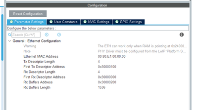

I am triyng to use STM32H735 with ethernet (ln8710A is the PHY)
We have hardware fault when we connect the cable (se the itm print below)
We use CubeMx version Version: 1.18.0
ETH is in RMII conection is OK

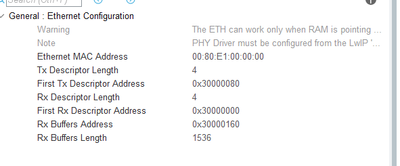

2025-06-16 2:10 AM

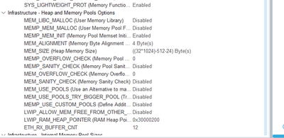

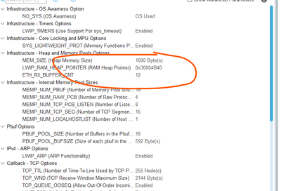

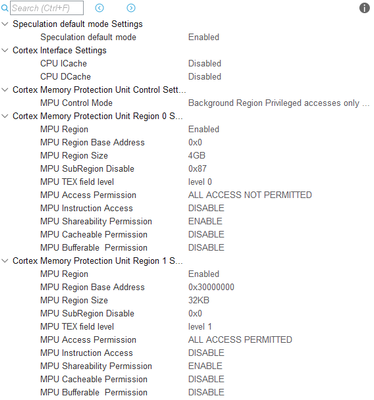

the hardware is good
we have test many configurations for memory position for Rx Tx and LwiRamHeap
In certain conditions hi dont remember its , I succeeded to ping my board , but
after several try of ping we have hardware fault
We think that it was bad configuration for Rx Tx and the heap description .
Can you help me to fit the good comfiguration

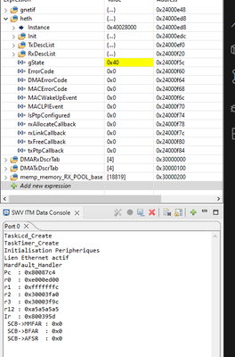

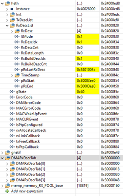

2025-06-16 8:07 AM
Now the stack is running
When we try to ping the board the response is OK
C:\Users>ping 192.0.1.218 -t
Envoi d’une requête 'Ping' 192.0.1.218 avec 32 octets de données :
Réponse de 192.0.1.218 : octets=32 temps<1ms TTL=255
but we have DMAErrorCode=0x4080 ? why ?

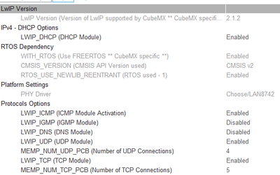

Hello
I’m using an STM32H735VGT6 with the PHY LAN8710, the hardware of the board is working.
I managed to generate a ping to the IP address: 182.00.01.228.
the configuration was :
Ethernet :
Lwip
When we connect the cable hard fault :
Nota : this project have been worked one night whithout probleme ,We dont understand .
We have not modified anythink and then he dont work ???
Is some one have develop an ethernet project with the stm32h735...
Please help
