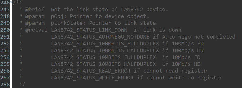

1.1. How to ensure that PHY is working correctly
In the PHY library (lan8742.h), the LAN8742_GetLinkState function is utilized to check the state of the PHY device specified in the parameters. As illustrated below, this function returns status codes that indicate the link status. It informs us if the link is up or down, the result of the autonegotiation process, and the selected speed and duplex settings. Additionally, it could signal if an error occurred during the read/write process to or from the registers.

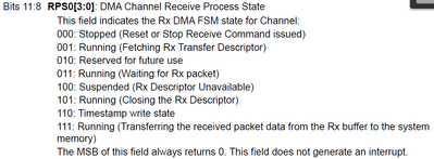

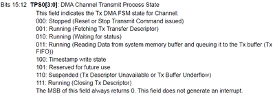

2.2 Debug status register (ETH_DMADSR)
This register provides us with the state of the Finite State Machine (FSM) for both DMA channels, transmit (Tx) and receive (Rx). It allows us to determine whether the Ethernet is functioning correctly. If there are issues, the register can help pinpoint the exact stage where the process is experiencing a hang-up.

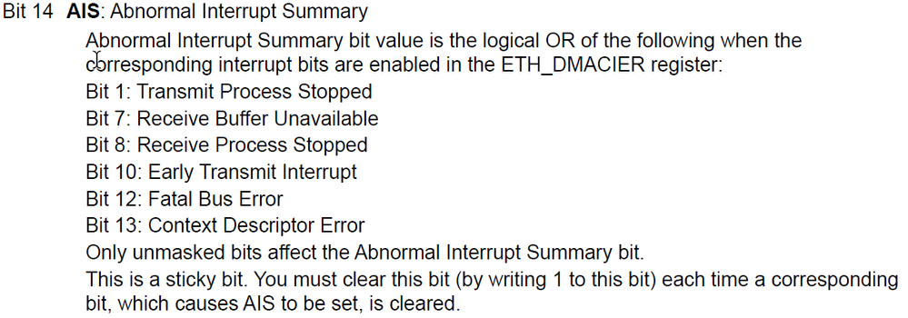

2.3. Channel status register (ETH_DMACSR)
During each interrupt routine, the application reads the status register to determine the current status of the DMA. This status can be found in the ETH_DMACSR register, which provides information on whether the transmit or receive process has been completed or if it has been halted due to an error. The types of errors that can be detected include unavailable receive or transmit buffers (RBU/TBU), context descriptor errors (CDE), or even fatal bus errors.
2.4. How to trace received packets in each layer
Before starting the tracing process, we need to make sure that the Ethernet has been initialized successfully by reading the value of the debug register (ETH_DMADSR). It should contain the value 3 (011) which indicates that the receive process is running correctly. Next, we can start checking the following registers:
