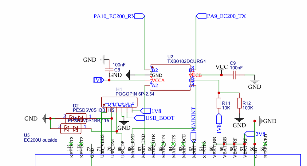

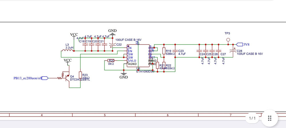

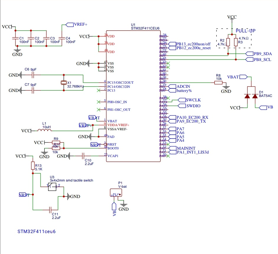

1} yes ,we are providing 3.5 V 4 A via power supply.
2}Yes , we have check using oscilloscope, after sending message or data on server , it gives spikes.
3} i have shared images of schematics . we have connected 2.2uF capacitor to NRST pin.
Edited to re-size images to a legible size
OK, this looks good to me, my only remarks are:
- The current limit of the Boost converter is set to 3.6A,  but according to the datsheet the effective current limit can be between 2.6 and 4.6A. Assuming that VCC is 3.3V this means the max. output current can be somewere between 2.2A and 4A
- The DTC043ZEBTL is an NPN Transister, but the schematic calls for an PNP (probably working because you are using the B-C Junction as diode).
To investigate the problem You can try to read the RCC_CSR register after the reset.
