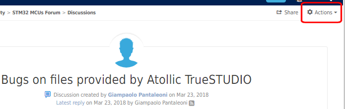

It would be more helpful if you changed the title to something specific; eg, 'Stack length wrong in Atollic linker file'
Giampaolo Pantaleoni
Posted on March 23, 2018 at 10:25
I completely agree with you, but I don't know how to change the title.
Giampaolo
Posted on March 23, 2018 at 11:07
There is a gear wheel icon at the top of the thread marked 'Actions' - it's in there:
