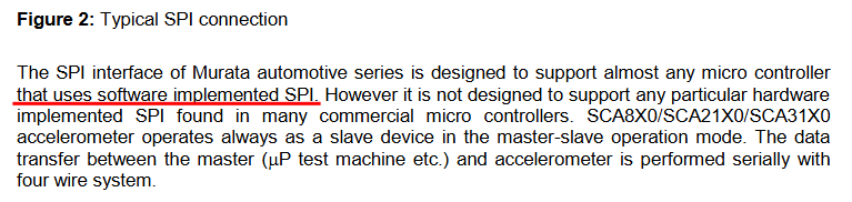

I need to connect thirdparty accelerometer SENSOR to STM32F4 series MCU via SPI.
The Sensor Data sheet says:
1) Designed to support any MCU  that used software implemented SPI. It is not designed to support any particular hardware implemented SPI.

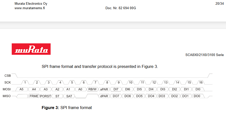

Murata is mfg. Please find the detailed data sheet attached. On page 20, it mentions about SPI.   I planned to use P/N SCA3100-D04.

Indeed, there it is:
You'll have to contact Murata to ask them what they actually mean by that.
But the Murata SPI frame is shown here:

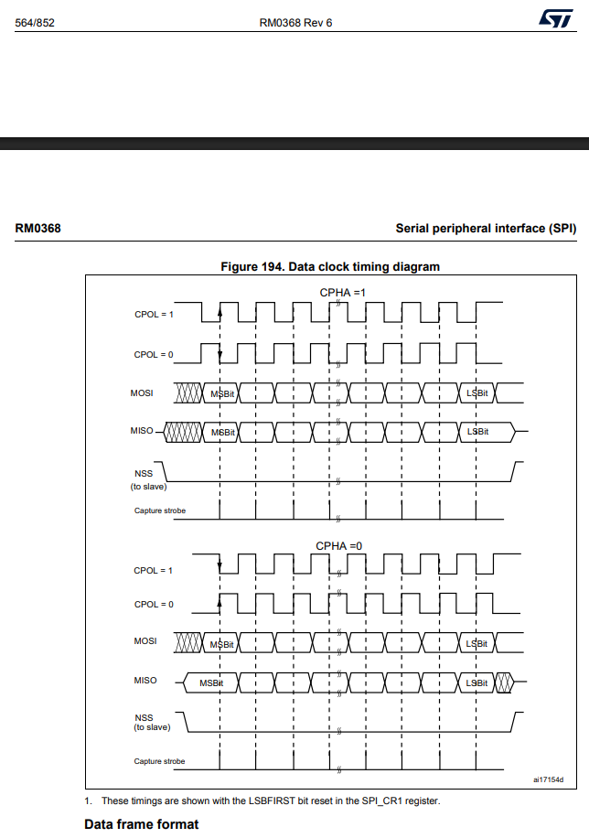

And the STM32's is here:
https://www.st.com/resource/en/reference_manual/rm0368-stm32f401xbc-and-stm32f401xde-advanced-armbased-32bit-mcus-stmicroelectronics.pdf#page=565
via: https://www.st.com/en/microcontrollers-microprocessors/stm32f401rd.html#documentation
So see which one matches.
There's only 4 modes to choose from ...
https://en.wikipedia.org/wiki/Serial_Peripheral_Interface#Mode_numbers

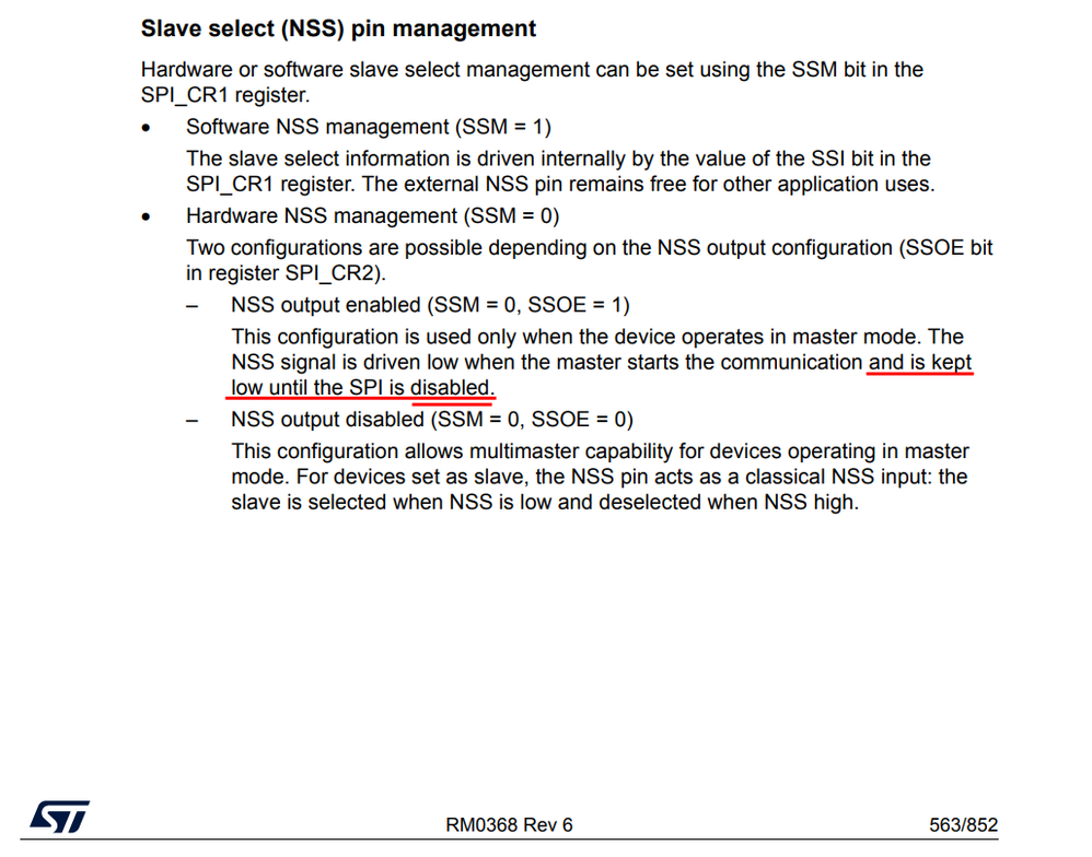

Note that the "automatic" NSS operation in the STM32F4 is probably not what you expect - or want:
So you'll probably want to do it "manually" in your software.
I think this is what they meant when they are saying Hardware and software. i have to use CS pin manually.    Other than this,   I am yet  to find out CHPA polarity.
I think the lanugage written in manual is confusing ..looks like auto converted from Chinese/Japanese to English...
I very much doubt it - that's a specific STM32 gotcha!
Yes, it does look like something got lost in translation.
Please feed back to Murata!
CPOL = 0 and CPHA = 0 clearly from the SPI diagram.
The chip doesn't know if you're using software or hardware SPI. It'll work fine with hardware SPI.
