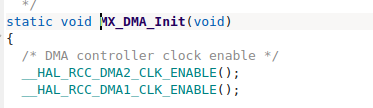

I am trying to jump user application from boot code:
Boot code only include below lines:
HAL_Init();
SystemClock_Config();
// Jump proccess start
uint32_t reset_handler_add=*((volatile uint32_t*)(FLASH_APP_START_ADDRESS+4));
void (*app_reset_handler)(void) = (void*)reset_handler_add;
HAL_RCC_DeInit();
HAL_DeInit();
__HAL_RCC_SYSCFG_CLK_DISABLE();
SysTick->CTRL = 0;
SysTick->LOAD = 0;
SysTick->VAL = 0;
__disable_irq();
SCB->VTOR = FLASH_APP_START_ADDRESS;
uint32_t msp_value = *((volatile uint32_t*)(FLASH_APP_START_ADDRESS));
__set_MSP(msp_value);
app_reset_handler();
Also #define FLASH_APP_START_ADDRESS 0x080A0000 this is application code start address.
But when I jump the User application I2C and DMA not working so, I couldnt use eeprom
In the User application I stuck in while (HAL_I2C_GetState(hi2c) != HAL_I2C_STATE_READY) function when I jump the User App. But If User App work on the base 0x080000000 address everything successfull, When I jump I have problem.

Does SysTick run?
If the code works in one scenario and not another, you're going to need to start​ comparing core and peripheral register states, and establishing where functionality starts breaking down.
Best ​to set VTOR on the app side using linker symbols, and not defines.
‎2022-02-03 4:48 AM
Yes Systic Run and another perhipheral UART etc run except I2C. Only I2C not working correctly.
I2C flag return always HAL_I2C_STATE_BUSY_TX when I want to use HAL_I2C_Master_Transmit_DMA in User Application.
But User Application if start in base 0x0800000 adress everything working perfectly.
In the boot application there is no initilize any perhipheral, I only init Systick and HAL init.
How can I do below advise ?
‎2022-02-03 6:12 AM
Failing in code you're not showing. Perhaps simplify the code you've shown so the base code at 0x08000000 transfers control immediately out of Reset_Handler so you can eliminate what that is doing.
Dump registers in the memory space as you would any other memory content, either dump data to a UART or use the debugger memory or peripheral views?​
The linker exports a symbol for the vector table, use that. Assuming some familiarity with assemblers, compilers, linkers and loaders..​
‎2022-02-03 6:54 AM
Very interesting but I solved.
Boot code does not include any DMA process but If I enable DMA clocks before the jump User App,
User App working correctly, If I disable this clocks before jump I get same error.
What is this situation reason, Does DMA only get clocks in start address (0x0800000) ?
