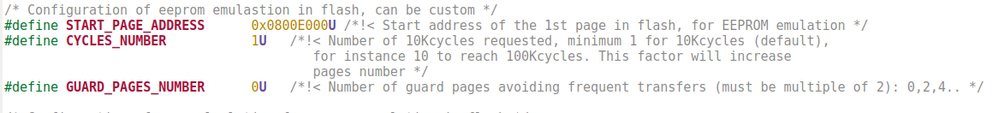

When I use GUARD_PAGES_NUMBER as 0, it uses 2 pages for the eeprom emulation, but the values that have been written are constantly updated, the 2-page field fills up and the change process does not occur again.

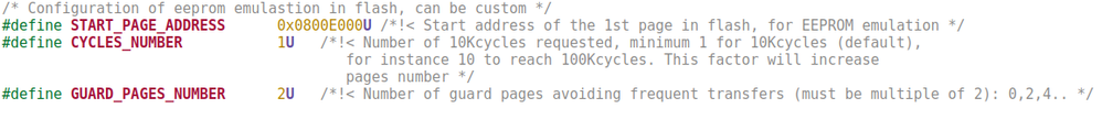

The value of GUARD_PAGES_NUMBER is 0, 2, 4 ... it can get its values. when I use the value 2. When updating the values, when the first 2 pages are full, the last values are copied to the other 2 pages and the values are not lost.
The protection of values is exactly what I want. But when I use it like this, at LEAST 4 PAGES are used. Each page is 2kb for the STM32G0 series, a total of 8kb is allocated for this process. Taking up 8kb of space for 128 values of 32 bits each is undesirable for my application.
