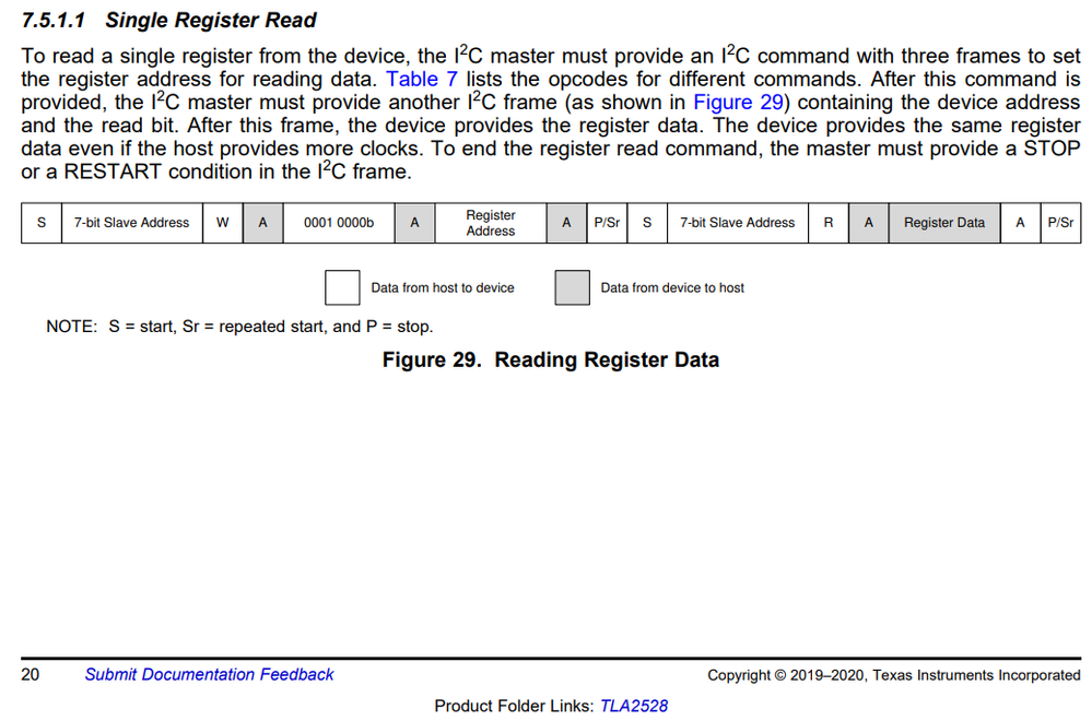

Andrew Neil
The datasheet says that a read should look like this:
