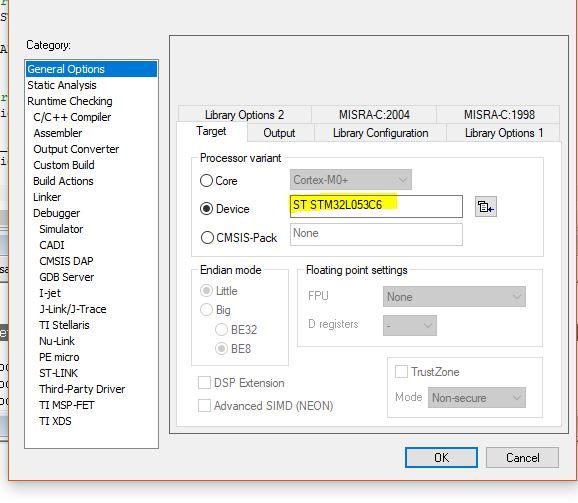

first go to MENU->project-> options and check the connected device
0693W000007CRlBQAW.jpgUse STLink utility from here

My IAR project is set to compile for STM32F103C8:
