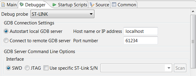

I am new to Atollic TrueStudio V9.1.0 on Win XP Pro SP3. I can create and build new project but Debug does nothing. I do not see the Binaries folder in the Project window. How and when and where does the Binaries folder get created?

  • You need to check the "Debug Configuration" (Run > Debug Configurations...) . From the "Debugger" tab, select the suitable Debug probe (ST-Link, Segger J-link...)

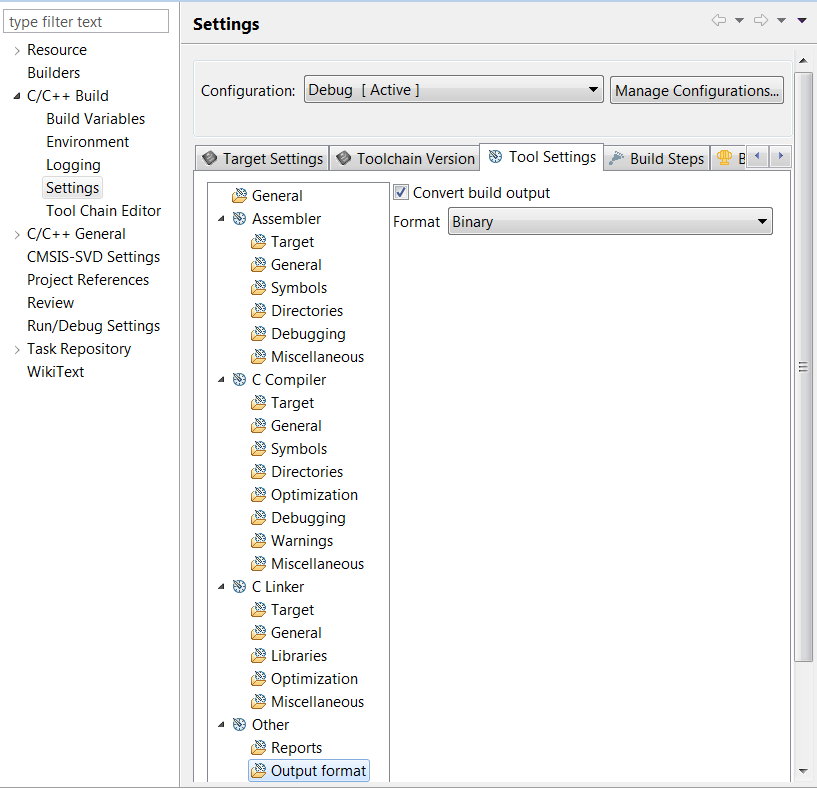

  • In order to generate the binary file with the build, you have to update "Build Settings" (Project > Build Settings). Go to "Tool Settings" tabe, Then in "Other", select the output format you want:

Thanks for the suggestions. I tried both. No joy.
Here is the build command.
13:03:23 **** Rebuild of configuration Debug for project Project001 ****
Info: Internal Builder is used for build
arm-atollic-eabi-gcc -c ..\Libraries\STM32F4xx_StdPeriph_Driver\src\stm32f4xx_pwr.c -mthumb -mcpu=cortex-m4 -mfloat-abi=hard -mfpu=fpv4-sp-d16 -std=gnu11 -DSTM32F4XX -DSTM32F40XX -DUSE_STDPERIPH_DRIVER -I../src -I../Libraries/CMSIS/Include -I../Libraries/Device/STM32F4xx/Include -I../Libraries/STM32F4xx_StdPeriph_Driver/inc -O0 -ffunction-sections -fdata-sections -g -fstack-usage -Wall -specs=nano.specs -o Libraries\STM32F4xx_StdPeriph_Driver\src\stm32f4xx_pwr.o
13:03:23 Build Finished (took 204ms)
Can you spot what is missing that prevents the Binaries folder from being created?
