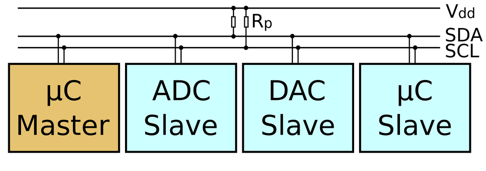

Besides, an I2C bus can be connected to more than one devices/slaves. I2C devices have addresses, so that it is possible to know what device you are currently using.
‎2021-07-06 6:05 AM
As @LMI2​ said, I2C is a bus - the whole point of a bus is that multiple devices can share it. That's why it has addresses.
You don't need a separate I2C for each peripheral:
