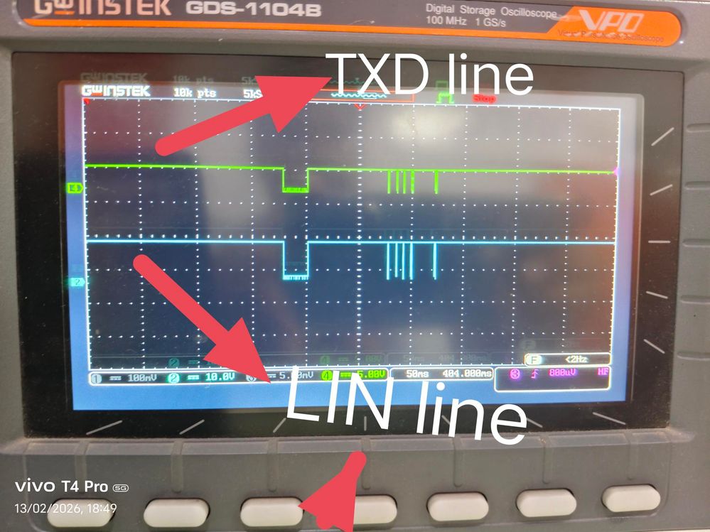

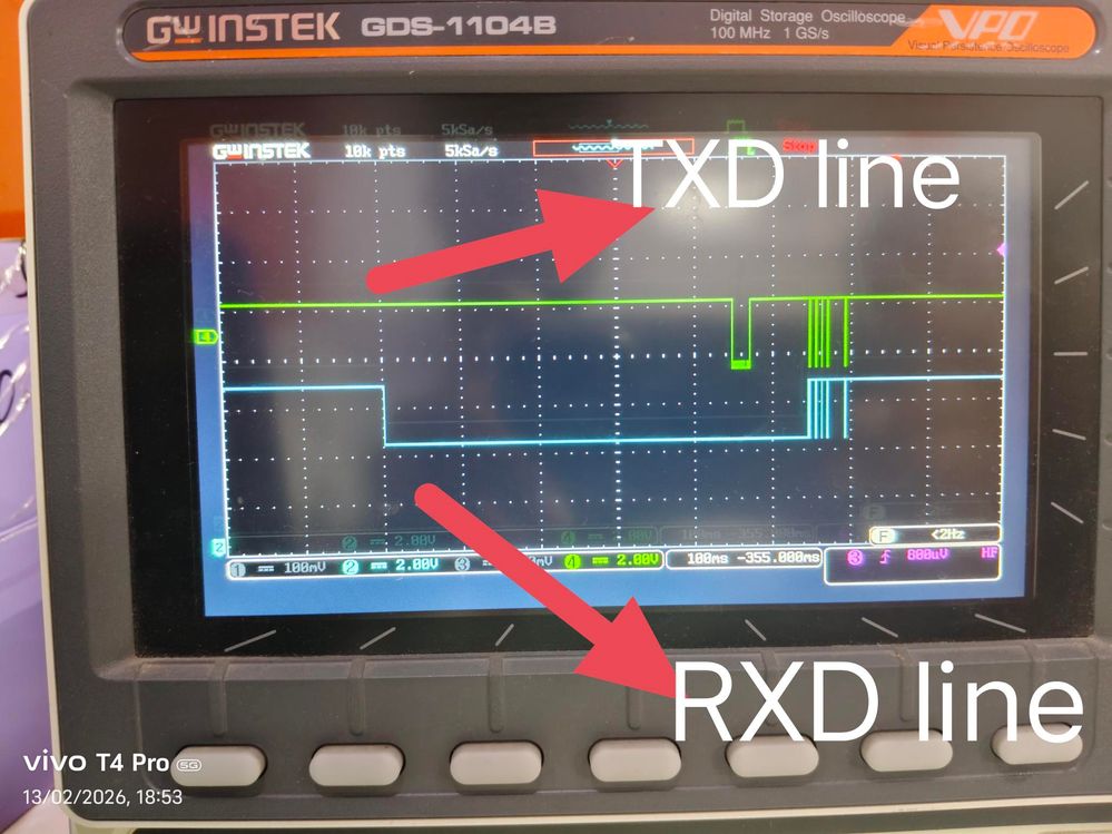

The hardware path appears to be working correctly. We verified using an oscilloscope that:
1.TXD from STM32H723ZGT6 is switching correctly
2.LIN bus shows dominant pulses during fast-init and UART transmission
3.RXD reflects the LIN signal

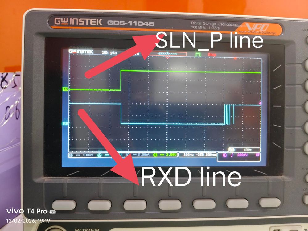

4.SLP_N LOW-to-HIGH transition is implemented after power-up
NXP support confirmed that the TJA1021T transceiver operation looks correct based on the waveform captures.
However, the ECU does not respond — only the transmitted request echo is observed.

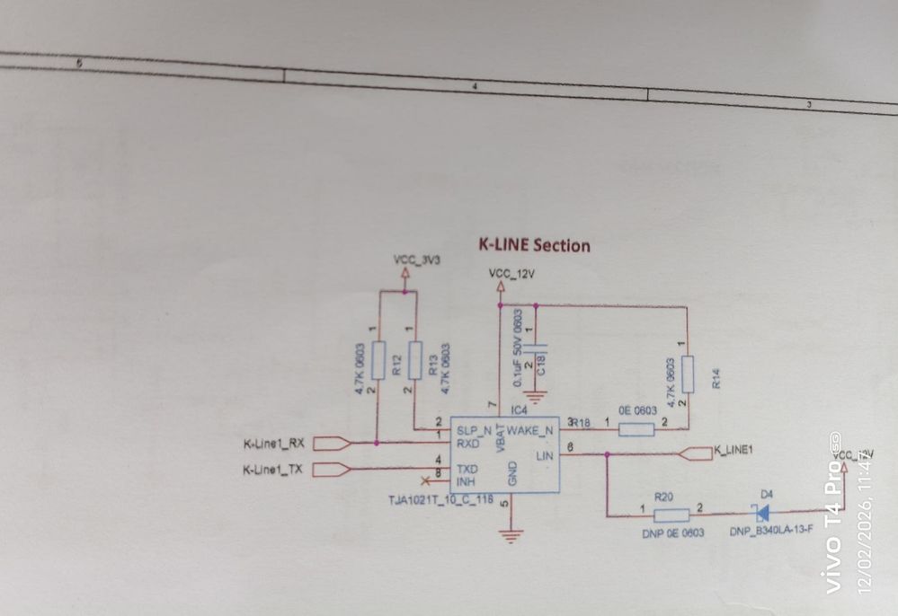

shared image (3).jfifshared image (2).jfifshared image (1).jfifhere SLP_N pin is connected to controller like gpio to handle low and high through firmware.here SLP_N pin is connected to controller like gpio to handle low and high through firmware.
