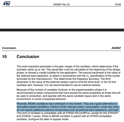

Hi! I’m starting design of a new board, on which I’d like to use an stm32h7 device. My board will also include an audio codec and usb hs phy.
Historically I’ve used crystals to drive HSE of the mcu, but some reference designs I’ve been studying show the use of cmos oscillators to drive the clock. I am curious about the trade offs of this, or how/when I should prefer a crystal over an oscillator?
thank you!

If you do a forum search, you'll find plenty of posts from people having trouble getting crystals to work.
See Application note AN2867Guidelines for oscillator design on STM8AF/AL/S and STM32 MCUs/MPUs, the datasheet for your chosen device, the hardware design guide, etc ...
Using a a ready-made oscillator saves you all that grief - no more worrying about load capacitors, drive strength, which cut, etc, etc, ...
They may also have reduced power consumption, smaller footprint, etc:
The downside, of course, is that they cost more.
This from SiTime focuses on the benefits of MEMS oscillators - but they would, wouldn't they?
Other oscillator manufacturers are available.
Some STM32 series may not be suitable; eg, see: MEMS oscillators not compatible with STM32F1 and STM32L1 series?
