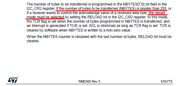

1. "The page write mode allows up to 256 bytes to be written in a single write cycle"
How is this achievable since the first two bytes are used for memory address and typically no more than 255 bytes total can be send over I2C in a single cycle? If I am correct, actually only 253 memory bytes can be written in one cycle. Please confirm/clarify.

typically no more than 255 bytes total can be sent over I2C in a single cycle? .
Where do you see that limitation?

@Andrew Neil Although, I think, the 255B limit is not part of the I2C specs, all the ST MCUs I came across have this hardware limitation since the internal I2C interface byte counter (I2C_CR2.NBYTES register) is 8 bit only.
I see.
But that's just a limitation of the STM32 - nothing to do with the M24M02E-F EEPROM.
How to get around the limitation:

@Andrew Neil Thanks for pointing this out. It was not a must, but it was was a good motivation to improve my i2c driver. Now the whole thing works like a dream.
