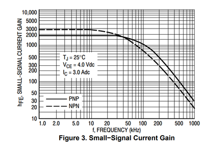

what is the maximum operating frequency of BDX33 and BDX34 ??

What do their datasheets say?
(it will also depend on your circuit, and what you consider to be the limiting factor(s) on performance)

These (old) darlingtons are more for small audio amps, see :
From ds i would recommend to use it at max. 30kHz (sine) , over 30kHz gain falling.
