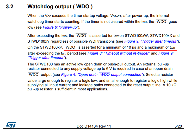

I use STWD100NY Watchdog IC and for now, i can not achieve what i want. The problem is about to get output from the WDO pin. I did not connect the WDO to the MCU but i connect it to drive a relay. I set up my timer to 4 seconds. Even if it exceeds the twd time, i can not get the signal from WDO pin. I attach my drawings below and needs your help. My Vcc is 5V( most setups use 3.3v but i think that i can choose it 5V according to datasheet ). R25 and R26 resistors are optional.watchdog IC.png

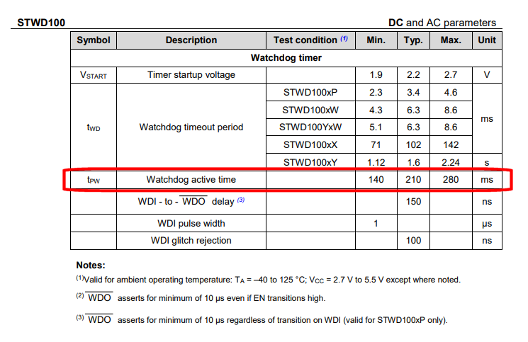

My bad, you re right i did not put any resistor but when writing here, i write as "planning to put 0R". By the way when changing the relay resistor, i am so close to my plan, when everything works well, IC reset itself by the help of WDI. By external pull-ups, i can drive relay at normal conditon. The remaining problem is this: when i adjust my timer to 2 sec, every transition, WDO toggles. I dont want the toggling process (i set up timer to high value to test if IC works). I attach a video related with that. The logic to latch the WDO confuses me.
That seems consistent with what the datasheet says:
So the WDO gives a pulse output with a width between 10us and 280ms.
Are you wanting it to stay asserted permanently once the watchdog has "fired" ?
