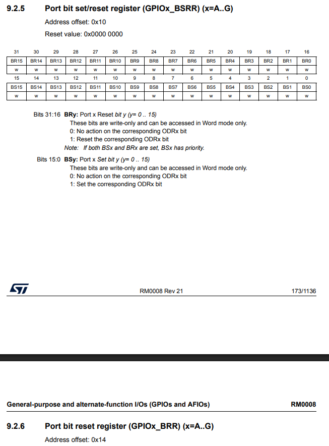

Instead of:
    	    delay_ms(1000);
    	    *GPIOx_ODR |=  (1<<13); // LED OFF
    	    //tempdelay();
    	    delay_ms(1000);
try:
    	    delay_ms(ms);
    	    //tempdelay();
    	    delay_ms(ms);
Also, rather than a read-modify-write (RMW) on ODR, look at BSRR and BRR:
https://www.st.com/resource/en/reference_manual/rm0008-stm32f101xx-stm32f102xx-stm32f103xx-stm32f105xx-and-stm32f107xx-advanced-armbased-32bit-mcus-stmicroelectronics.pdf#page=173
via: https://www.st.com/en/microcontrollers-microprocessors/stm32f103c8.html#documentation
