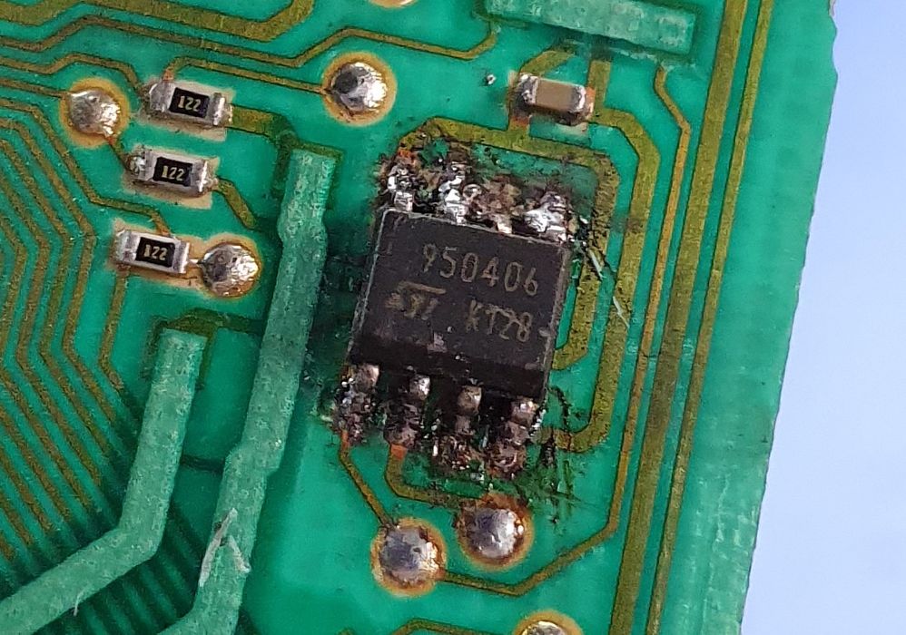

It is for a veglia boreti automotive instrument cluster from a fiat punto 2001 - 1999
Hi there! I wanted to politely ask for your help, if you can answer a simple question: i have a 950406 k128 eeprom chip but cant find one to buy online i only can find 950406 K506W or 950406 K304K, if so can i use these other ones to replace the 950406 k128

After investigations, you can use both of the 2 parts.
But i would recommend you to use the 950406 K304K which is manufactured with the last process technology.
BR
Team EEPROM suPPort
2021-04-27 1:45 AM
thanks a lot the brand doesnt matter right? ;)
