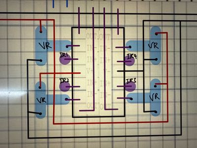

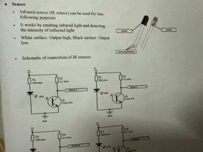

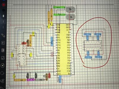

IMG_4839.pngI would like to connect the LM324(below) to the STM32F103C8T6 on a donut board, purpose to read four IR receivers. VR with highlight T shape is preset 103. IR1, IR2, IR3, IR4, 5V and ground will connect to a 6 pin header, connect to another donut board which contains only 4 groups of IR transmitters and receivers.
My task is without jumper wires connect them together but I can’t connect it due to the preset 103 make the circuit too messy. Can anyone help me please.:folded_hands:

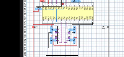

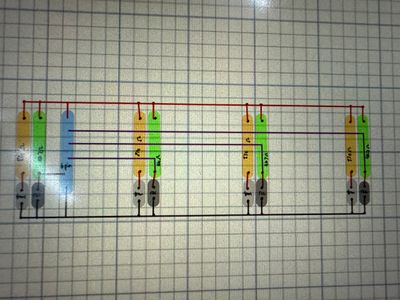

I think that is not important, I’m new on this, I want to build a follow line autocar, these will be the sensors.
These two pictures are two drafts of donut board. I want to connect the circuit on donut board without using jumper wires. Others I have already connected. Only the LM324(circle with red pen) I can’t connect due to too many preset 103 need to connect with 5V and GND and there is no way to connect “input+” on LM324

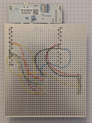

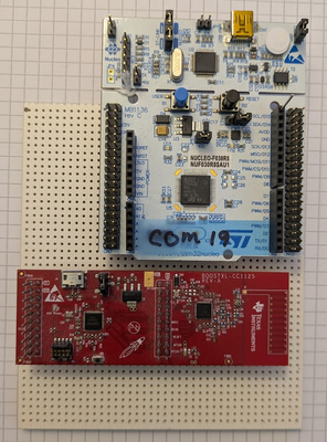

Here's one I'm using at this very moment:
PS:
Some more examples here.

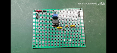

My task is connect LM324 to STM32, preset 103 and four of the “input+” connect to 6 pin header (another 2 pin is for 5v and gnd). Connecting them on donut board without jumper wires, only soldering.
Problem I’m facing is each preset 103 need to connect to 5v, gnd and “input-” on LM324. When four of them connect to 5v and gnd, there’s not enough space to connect others pin.
 This image is incorrect because four “input+” didn’t connect to 6 pin header.
Target:
LM324 Output(4) > STM32 pin(4)
LM324 Input-(4) > preset 103(4) > 5v, gnd
LM324 Input+(4) > 6 pin header(1)
V+ > 5v
V- > gnd
zimin

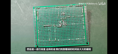

I haven’t learn this yet. I need to connect them on donut board by soldering.
This is an example but my task more difficult because more component used. My lecturer don’t want the circuit is messy so don’t allow to use jumper wires I think, and it might be a challenge on soldering.
