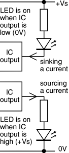

Hi Usualy I see terms called pushpull configuration,open drain, pull up ,pull down and so on.what are the difference between them

Source/Sourcing and Sink/Sinking are also common terms relevant here:
https://electronicsclub.info/ics.htm#:~:text=Sinking%20and%20sourcing%20current
  • A Push-Pull output can both source and sink;
  • An Open-Drain (or Open-Collector) output can only sink.
