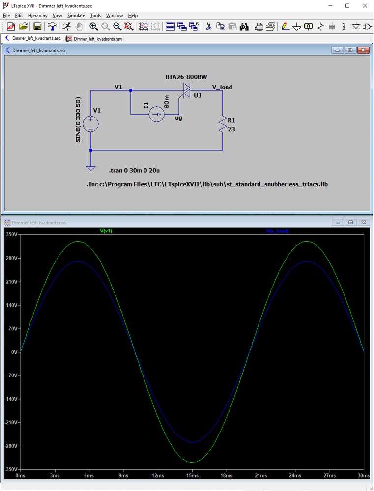

BTA26-800 SPICE MODEL
JHarm
I used spice model downloaded from ST product page. But model behaviour is highly strange in LTspice XVII. There is 60V Gate voltage in I. and IV. quandrant. Negative gate current turn triac ON only in one quadrant.0690X0000087WhcQAE.png
Is it possible to use ST models in LTspice? Or does exist some model for LTspice?
