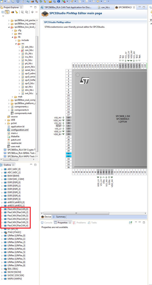

i am using SPC560B54L5 EVK board . i have implemented code for 3 CAN in project first can channel is working fine but second & third channel is not working.when i am sending message through PCAN then respective IFRL & IFRH buffer (interrupt ) has not generated.

0690X0000088sEPQAY.pngHello ,
You can find some example in SPC5STudio
SPC560Bxx_RLA CAN Test Application for Discovery
Have you configured correctly the Pinmap Wizard ?

i have checked with configuration still not working but i am testing only can 2 channel or any setting required for pin mapping? thanks in advanced
this setting for board.c
 {(int32_t)PCR(PORT_B, PIN_CAN1TX), PAL_LOW,  (iomode_t)(PAL_MODE_OUTPUT_ALTERNATE(1))},
 {(int32_t)PCR(PORT_B, PIN_CAN1RX), PAL_LOW,  (iomode_t)(PAL_MODE_INPUT)},
this for board.h
#define PIN_CAN1TX         10U
#define PIN_CAN1RX         11U
