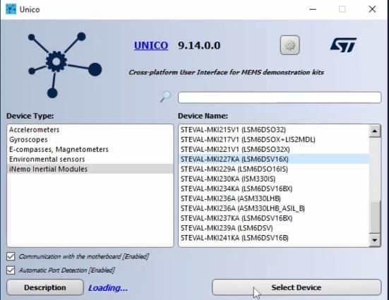

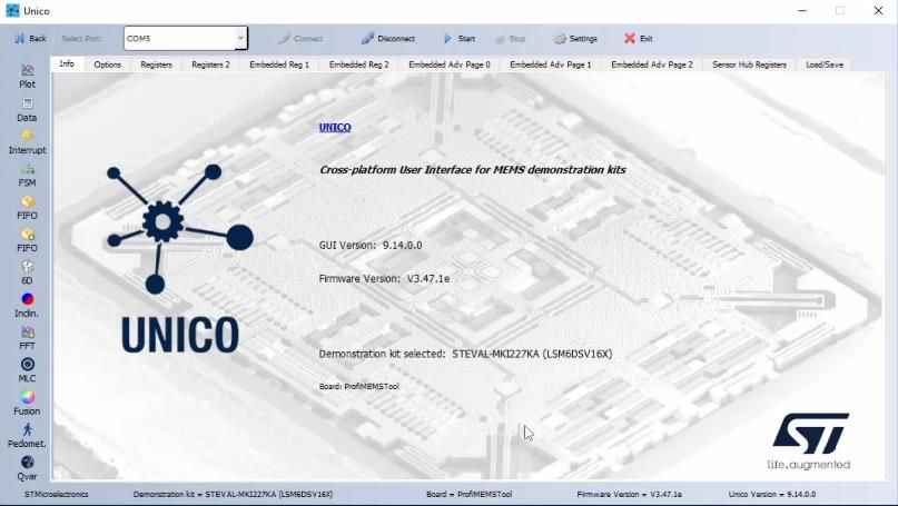

After opening Unico-GUI it is needed to select the device LSM6DSV16X with its adapter board, the STEVAL-MKI227KA.

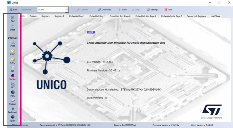

Once pressed on “Select Device” button, it is possible to see on the left hand side all the in the edge functionalities of the device: FSM, MLC, Pedometer, Sensor Fusion, Qvar.
Clicking on the Start button on the top bar we are enabling the communication between the STEVAL-MKI109V3 with the STEVAL-MKI227KA and our PC.

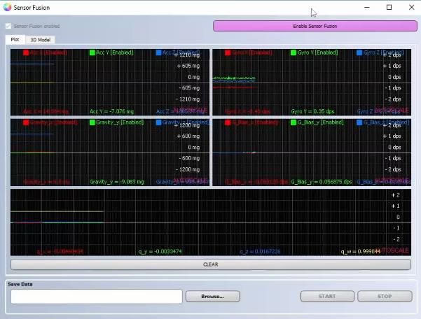

Let us start by enabling the sensor fusion pressing on the fusion tool and then on “Enable sensor fusion” button.
To know more about the sensor fusion please refer to this knowledge article.

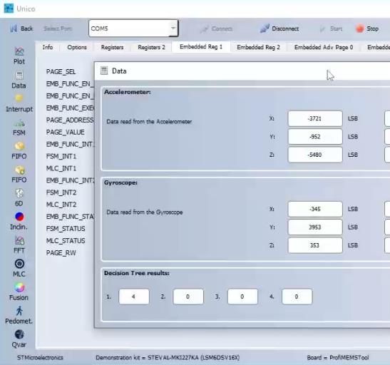

Let us now upload the Machine Learning configuration. For this knowledge article I used one of the MLC already existing configurations present on the MEMS GitHub repository.
More specifically, the configuration was the one for the gym activity recognition for the right hand.
At this link you can find the prebuilt configuration: https://github.com/STMicroelectronics/STMems_Machine_Learning_Core/tree/master/application_examples/lsm6dsv16x/gym_activity_recognition

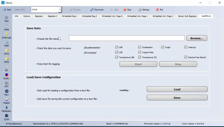

Once downloaded the UCF file, on Unico-GUI it is needed to select the load/save bar and load the .ucf configuration.
The selected configuration shows the MLC output as follow and as they are explained in the readme file in GitHub:
  • 0–Steady
  • 4–Biceps curls
  • 8–Lateral rise
  • 12–Squat

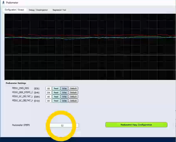

Pedometer

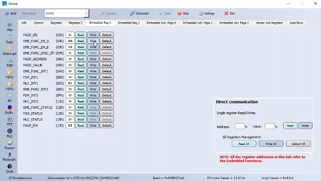

Finally, we can enable the pedometer 2.0 by setting the PEDO_EN bit available in the EMB_FUNC_EN_A register. In this case, let us go to the Embedded Reg 1 tab and write manually the value 0A in the register 04.
It is possible to immediately check the pedometer output by clicking on the pedometer button.

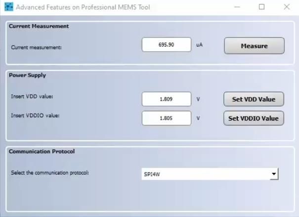

From the same page and by clicking on advanced features it is possible to check the power consumption while moving the board, it includes the sensor fusion, the pedometer, the MLC, and the accelerometer and gyroscope power consumption.

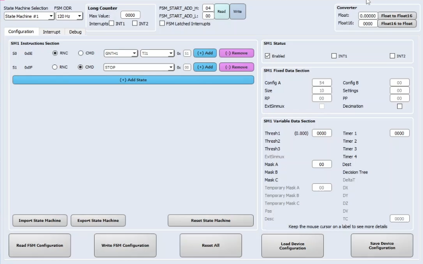

Now that the configuration is completed there is the need to implement the following flow leveraging the FSM tool.

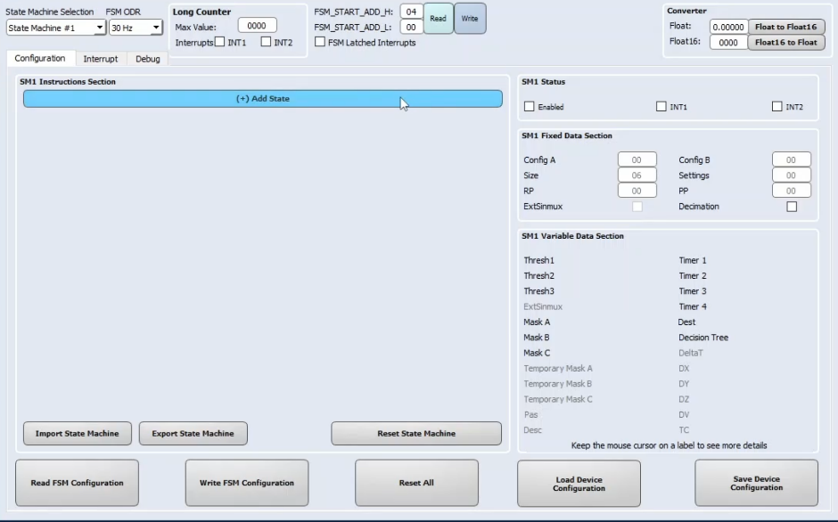

After clicking on the FSM button, the FSM screen will open.
The first step is to align the FSM ODR to the sensors ODR, which is 120 Hz.

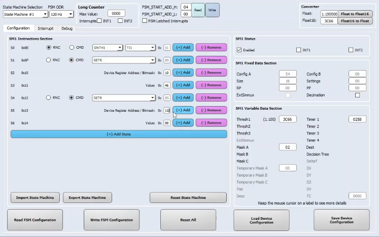

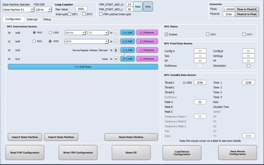

Now, we can start building the program. Since the device starts in a wake state, where accelerometer and gyroscope sensors are in high-performance mode, we need the device to enter in a sleep state, meaning that only the accelerometer is kept on in low-power mode. The sleep state is enabled when the device is kept stationary for a while, for example 5 seconds.
During movements, the accelerometer and gyroscope sensors are configured at 120 Hz in high-performance mode. During this condition, the MLC, the pedometer 2.0 and the SFLP are fully functional. The sensor provides Gym Activity Recognition output, the number of steps and the orientation of the device.

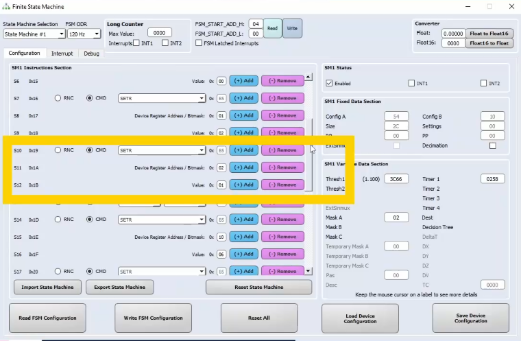

To enter the sleep state, the first instruction of the FSM will be a GNTH1 | TI1 condition. The configured threshold is 1.1 g applied on the accelerometer norm signal, and the timer is 600 samples (which means 5 seconds at 120 Hz). Anyway, you can refer to the AN5882 for getting more details about the FSM conditions.

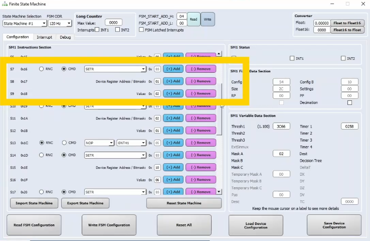

The next instruction will be reached when the device is stationary for 5 seconds. When it happens, we want to turn off the gyroscope and to set the accelerometer in low-power mode. For this purpose, four consecutive SETR commands are issued, one for changing the accelerometer power mode, and one for turning off the gyroscope.
Another SETR command is used to disable the pedometer during the stationarity. The SETR command takes as first bit the argument the value 01, which means register embedded function enable A and as second argument the bite 02, which means that the pedometer is disabled while the sensor fusion is kept on.

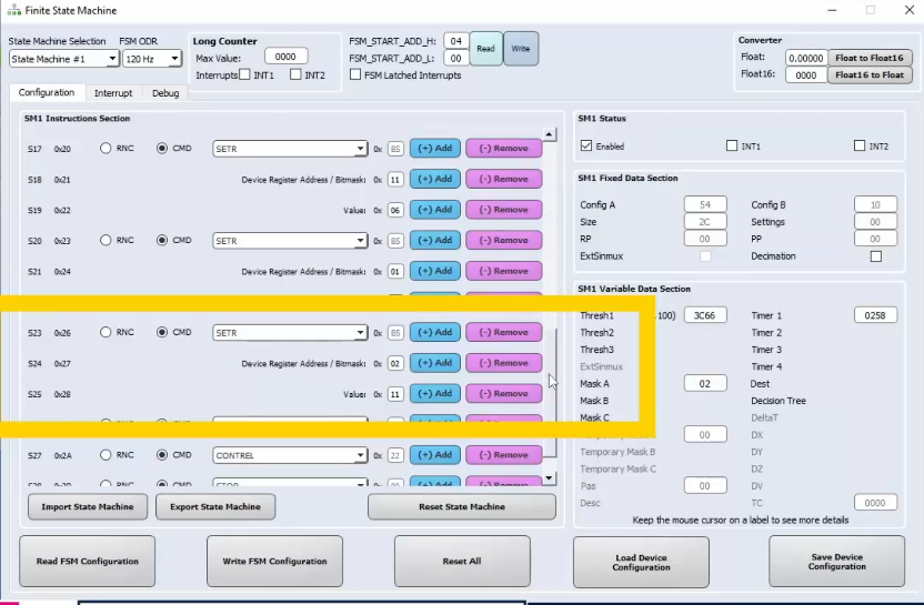

The fourth SETR command is used to disable the MLC during stationarity. The first argument is the bite 02 and the second argument is the bite 01 which means that the MLC is disabled while the sensor fusion is kept on.

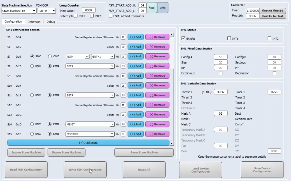

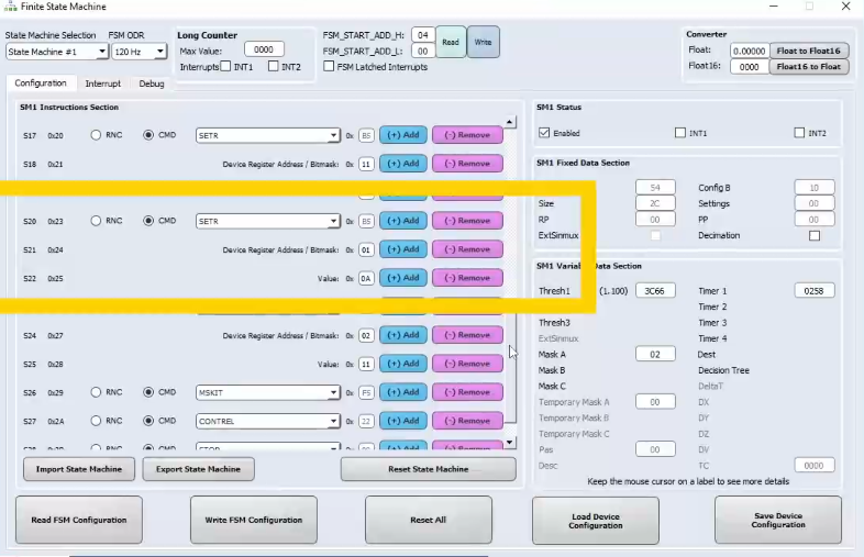

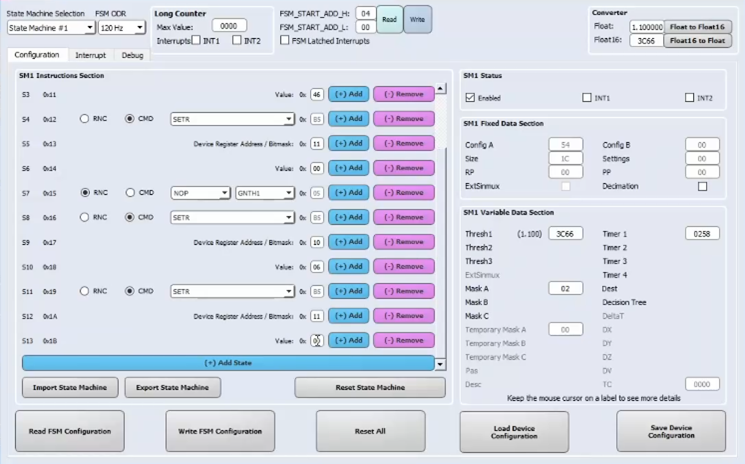

Then, we need to configure a wake-up able to set the accelerometer and gyroscope sensors back to 120 Hz in high-performance mode. In this case, the wake-up condition is a NOP | GNTH1, using the same threshold used before. Once the wake-up signal is detected, we need to configure other four consecutives SETR commands to change again the sensors configuration.
The first and the second one are needed to set the accelerometer and gyroscope back to 120Hz in high performance mode.
The third SETR command is used to enable the pedometer when the wake-up is detected, the first argument is the bite 01 and the second is the bite 0A, which means that the pedometer is wakened up together with the sensor fusion.
Finally, the last SETR command is used to enable the MLC after a smart wake-up is detected.
The first argument is bite 02 and the second is bite 11, which means that the MLC is enabled together with the sensor fusion.
Moreover, we need to reset the program by using the CONTREL command. To avoid generating an interrupt, the MSKIT command is issued before the CONTREL command.

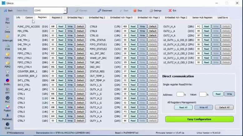

To allow the FSM writing the device registers using SETR commands (which means to enable the ASC feature), we need also the set the FSM_WR_CTRL_EN bit available in the FUNC_CFG_ACCESS register. Let us go to the Registers tab to set manually this bit to 1
Let us open again the sensor fusion, the machine learning core and the pedometer views. During movements, we can see that the current consumption of the device is the same as before. But, when the board is stationary for more than 5 seconds, the current consumption drops significantly. An important thing to highlight is that when the board starts moving, the orientation of the teapot is not affected by the gyroscope turning-on and accelerometer power-mode change.
