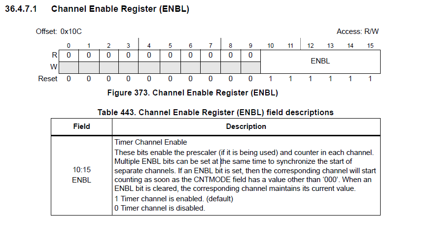

Did you try to disable the timer before shifting the phase ?
      Best regards
                  Erwan
Posted on October 26, 2017 at 03:03
Hello
Yvin.Erwan
Thank you so much for quick reply!
In my program, I haven't used ENBL register before shifting the phase.
Is it require whenever we want to update the counting number in COMP1 or COMP2 registers?
Best regards;
Tran Hung.
Posted on October 26, 2017 at 10:14
No Tran ,  in fact it is not required.
i will give you a feedback from our experts as soon as possible
             Best Regards
                         Erwan
