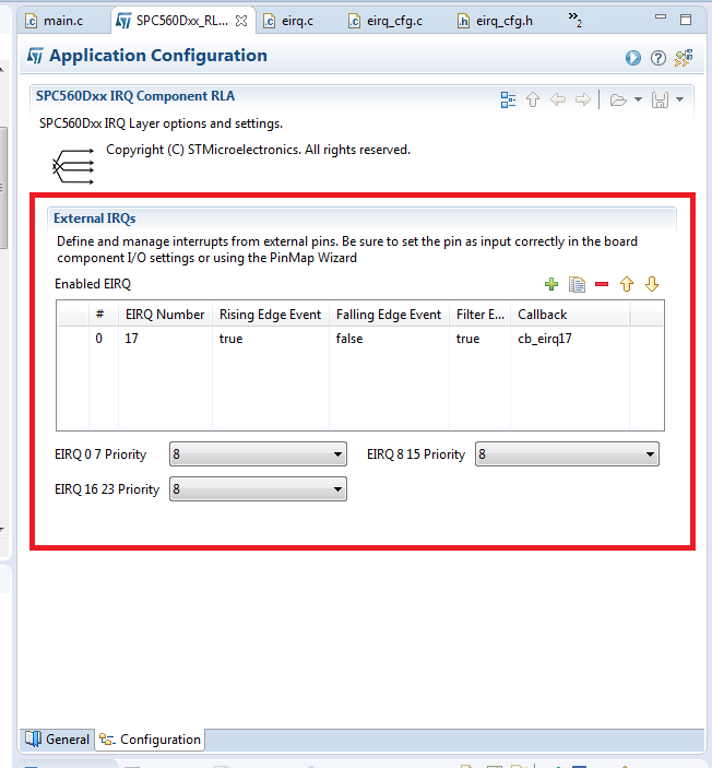

I will be grateful if you guide me is there any way to auto generate the callback code definitions in eirq_cfg.h and eirq_cfg.c for the corresponding EIRQs selected.
For example:
For eirq17, definitions like
void cb_eirq17(void) in eirq_cfg.h and
{17,TRUE,FALSE,TRUE,cb_eirq17}, in eirq_cfg.c
‎2017-02-07 6:33 AM
Hello R. Santhamuthy,
you have update IRQ Component RLA to update it (cf screenshot)
do not forget to save your configuration before generation)
Best regards
Erwan
