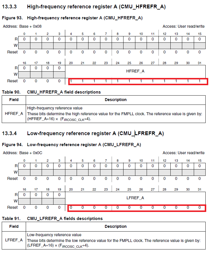

Reading the user manual (RM0032) at page 277 13.3.3 and 13.3.4, I've found some details on the CMU_HFREFR_A and CMU_LFREFR_A registers, but I have some questions.
First question: when is the FMPLL clock checked? Whwnever I start the CMU by setting the SFM bit in the CSR register?
Second question:
Table 90 says: These bits determine the high reference value for the FMPLL clock. The reference value is given by: (HFREF_A÷16) × (FIRCOSC_CLK÷4).
Table 90 says:
These bits determine the low reference value for the FMPLL clock. The reference value is given by: (LFREF_A÷16) × (FIRCOSC_CLK÷4).
HFREF and LFREF are the contents of the two register, but what is FIRCOSC_CLK? Is it a predefined value or the content of a register, or what?

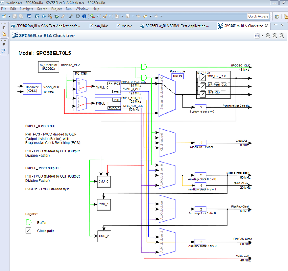

Hello Alessandro ,
Do not hesitate to use the Clocktree wizard (cf screenshot) relative to
SPC56EL60L3 (cf RLA Application)
FIRCOSC_CLK is
The internal RC oscillator
it has a nominal frequency of 16 MHz.
The predefined value should be the reset values (cf below)
