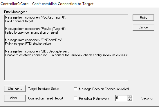

with PLS JTAG and UDE STK 5.2 to debug SPC563M board,i cannot link to the board rightly,why?
xqing.1
3 REPLIES 3
xqing.1
xqing.1

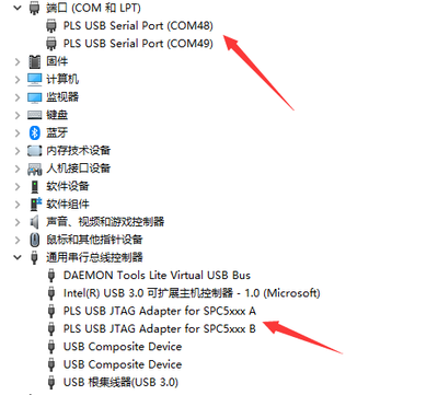

how to solve my this problem?   the driver for PLS JTAG looks like normally!
