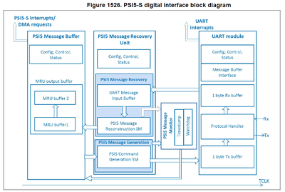

I am currently developing UART functionality on the SPC58EG chip, and I want to use LinFlexD1 hardware channel to develop UART.
However, I cannot find relevant examples in the SPC5 Studio IDE.
I am referring to the official manual (RM0391), which mentions that the Peripheral Sensor Interface-Support module (PSI5-S) must be enabled and related registers modified to use LinFlexD as UART.
Are there any more specific example codes or projects that can be used as a reference for developing UART?
Thank you.

Hello Fukai ,
There is no specific example for the IP PSI5-S modes.
I recommend to fork serial_lld.c in SPC5Studio
           Best regards
Picture to supplement the description

hi Erwan,
thank you for your reply.
I find the definitions and functions for UART in serial_lld.c and its related files in SPC5Studio.
Can I use these files in other IDE directly or I can use in SPC5Studio only?
