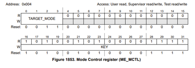

Hi! I haven't used that specific microcontroller before, but there should be a MCTL register in the ME (Mode Entry) module. Setting the target mode field to RESET should trigger a restart of the system. You also have to supply the correct key to make the mode transition valid. All this should be explained in the reference manual.
