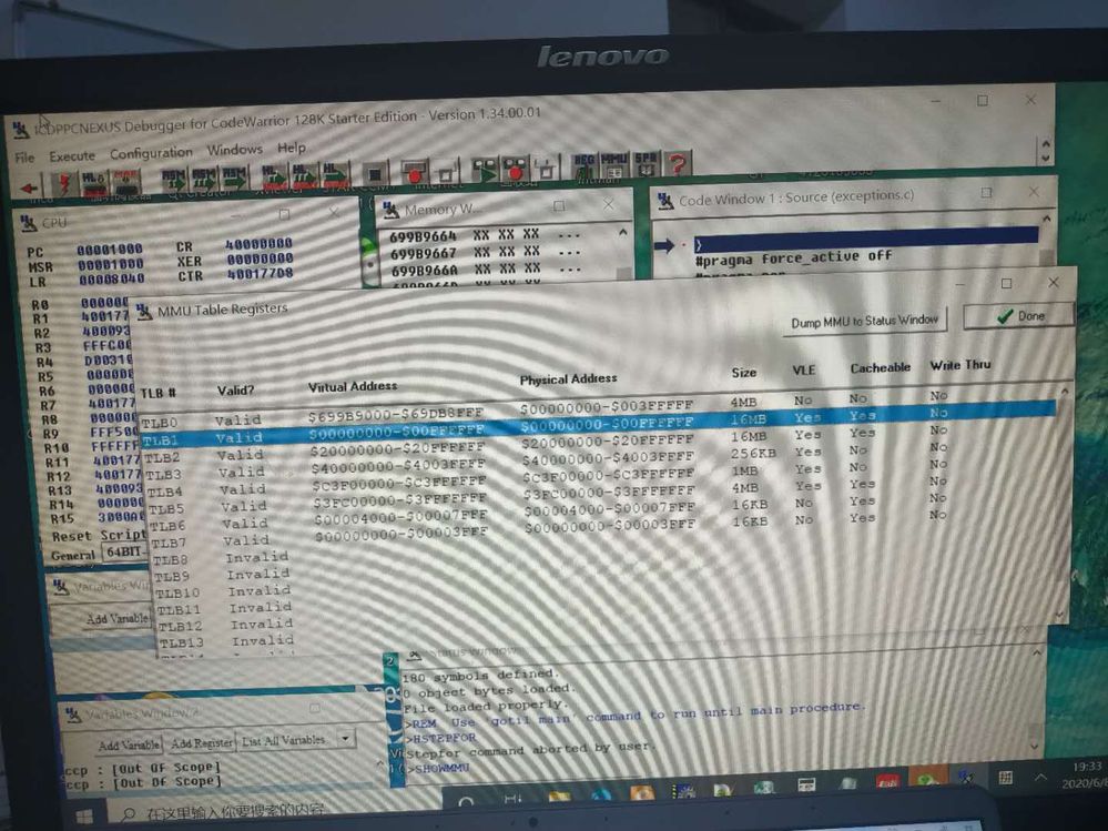

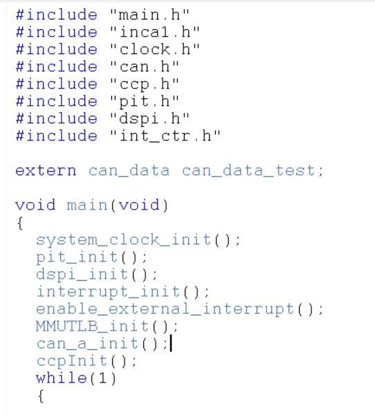

The MCU is SPC563M64. After configuration of TLB1 entry 1, the program can not run normally!!!
增祝.1
The code is as followed. When i delete TLB entry 1 configuration code, the program can run normally!! Why?:confounded_face:

after debug, i found the TLB1 entry0 has been changed, but code don't change it. 0693W000001qEYZQA2.jpg
