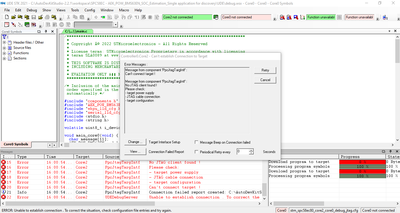

I am currently using SPC58EC but when I load workspace from UDE STK 2021 in windows 10 it said that:
Message from component 'PpcJtagTargIntf' :
Can't connect target !
No JTAG client found !
Please check:
- target power supply
- JTAG cable connection
- target configuration

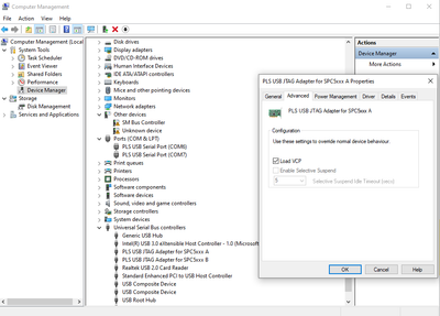

Eventhough I already enabled load VCP and reinstalled with UDE STK 5.02.04 but it still can't connect target. Whenever I press retry, my board flashed a green LED D5. I upload the log file as well as device manager and error pics. Please help me.

The issue is with the FTDI drivers probably not recognized in your PC.
Download and install according to your Window Version    Drivers - FTDI (ftdichip.com)
After connect the board via USB, and check in the Device Manager folder in Windows that UDE has been properly recognized.
