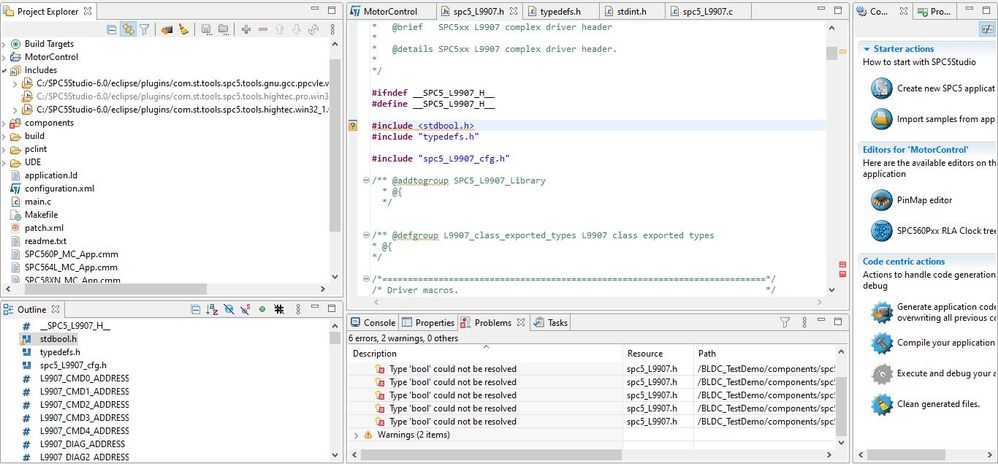

In motor control applications, <stddef.h> , <stdbool.h> are not defined. How to include these libraries??

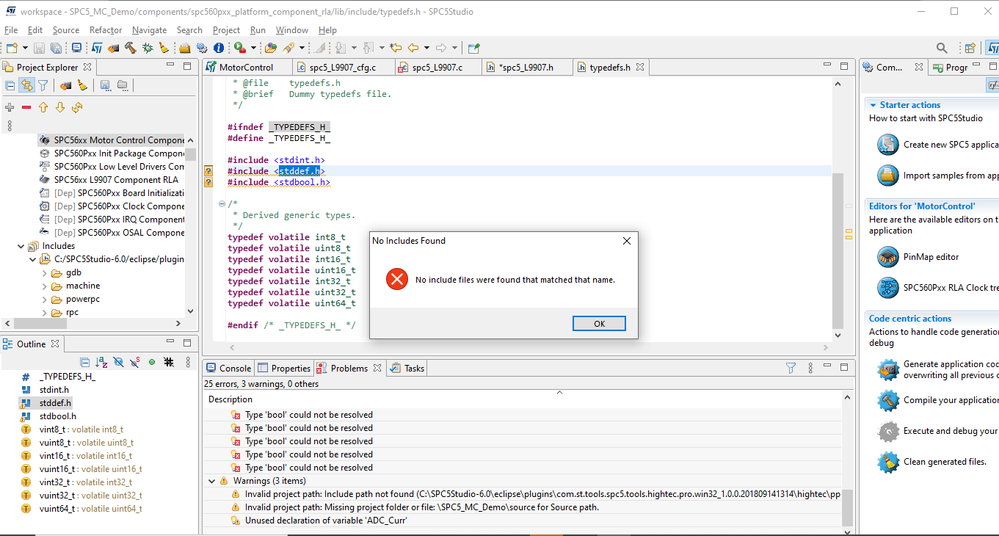

Hi Chia,
I already have these includes in my project. But one include shows error which you can see from the attachment. Can you help me out?
PChia.2237
Senior
Look what you have include.
One time folder us under gnu.gcc and other is under hightec. These are 2 different compilator. Dont mix files.
Remove folder under hightec and search file (in windows) under
C:\SPC5Studio-6.0\eclipse\plugins\com.st.tools.spc5.tools.gnu.gcc.ppcvle.win32_4.9.4.20200908161514\
The you find the files that you need, the include the folder.
ok?
