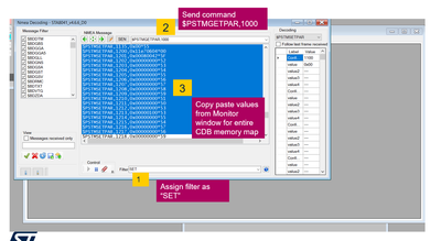

Aug 19, 2024 18:33 UTC
Can you please execute this command in Teseo Suite Monitor Window ?
$PSTMGETPARM,1000
Please copy the CDB values and attach it.
I will compare with the VIC3DA I have.
