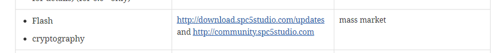

Hello ,
you can access to this library by downloading it by update site mecanism :
http://download.spc5studio.com/updates/
cf screenshot
Best regards
Erwan
