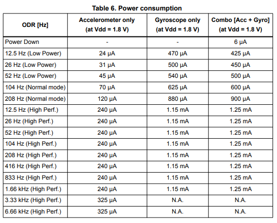

What is the LSM6DS3 gyroscope current consumption while in sleep mode?
PBitt.1
I could not find this information in the datasheet or app note (just power down, LP, NM, and HP modes).

Hi @PBitt.1​ , please note that the sleep mode is another name for the power down mode. You can set in sleep mode the accelerometer and the gyroscope separately, while power down mode is more relate to both sensors sleeping. For this reason, the table below is the reference one (see also AN4650 p.21).
Regards

This happens because the circuitry part of the gyro is "sleeping" while the accelerometer is however still running. In theory, since the MEMS finger capacitors are high impedance node, even if you power them with a difference of potential you will not have a conducting path, so ho additional current consumption.Btw, when gyro is in sleep mode, the accelerometer should be running, so the main contribution is the accelerometer one. Regards
