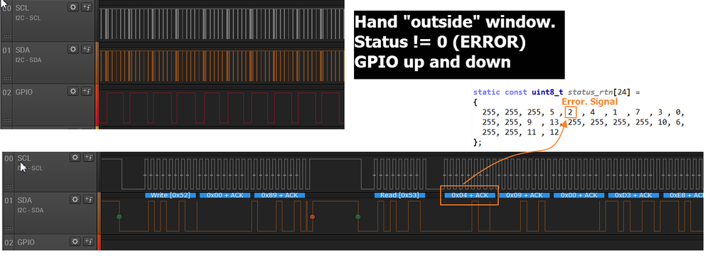

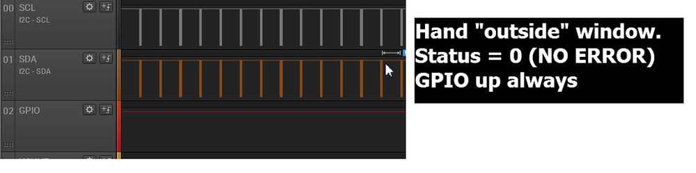

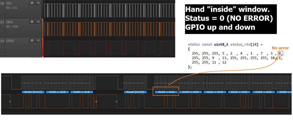

I include some images to better illustrate my problem.
If my hand is:
  • Within window --> status = 0 --> GPIO interrupt goes up and down --> OK
  • Below or beyond window --> status = 0 --> GPIO interrut is high all the time --> OK
  • Beyond window --> status != 0 --> GPIO interrupt goes up and down --> Is this correct behaviour??
Is this the correct behaviour of GPIO pin?

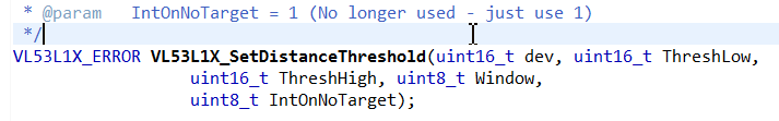

I used value = 1 as indicated by the API comment:
Julien NGUYEN
​Hi Hardwariano,
It is a mistake of our part. We will correct the error. Thanks, Julien
